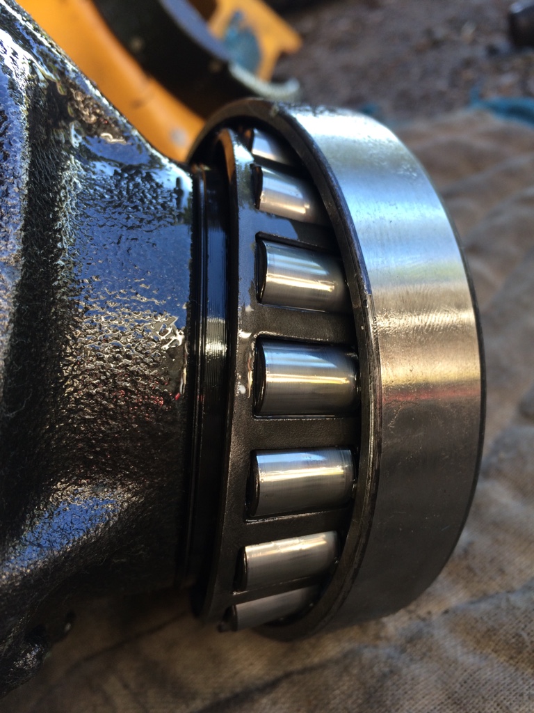

Need help! Trying to do my front diff with a grizzly locker at home, hoping to get it done tonight.
May be a dumb question but are the shims under the bearing on the carrier? Looks like they might be from looking at it, no shims came out of the sides when it was removed. I'd pull the bearings off to see but don't have a bearing puller at home I just bought new bearings for the locker didn't plan on trying to remove the old bearings.

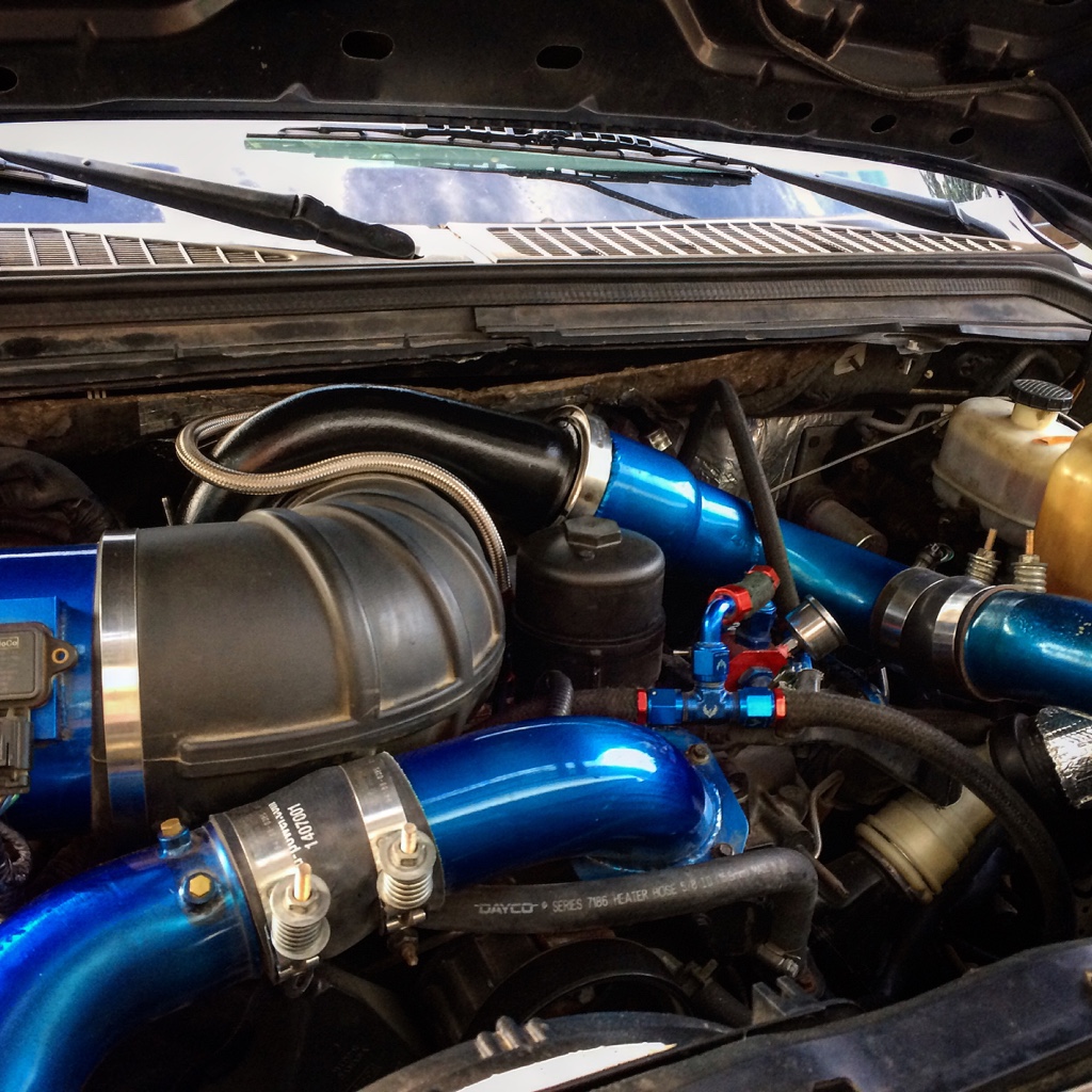

New setup, s475 turbo after my batmowheel blew a few weeks ago.
100 over nozzles and dual fuelers on their way hope to have them in next week.
