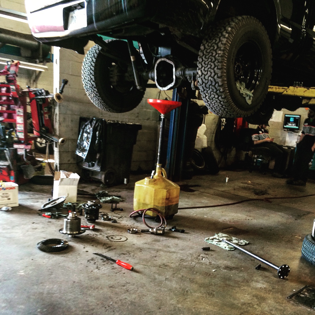

Thinking about changing my tire set up. I'm the only one left in the class not running an aggressive mud terrain tire this season. Seems like the all terrains are really hurting my distances on the looser tracks. May go for a toyo M/T or Goodyear duratracs seem to work well for most. Next pull is this Saturday at the Milton Country heritage fair. Going to try and get my tru trac in this week, remove rear seat so I can hang all 400 lbs of case weights off the front and see if it helps.
