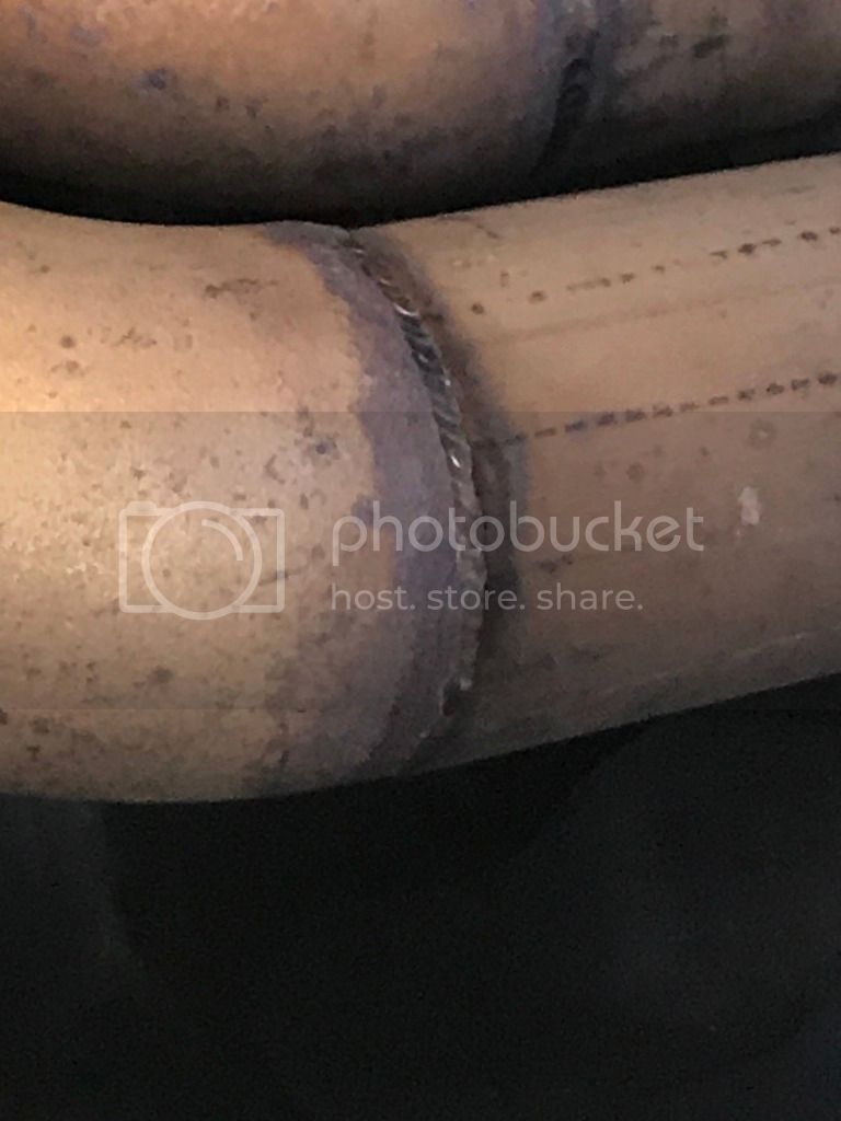

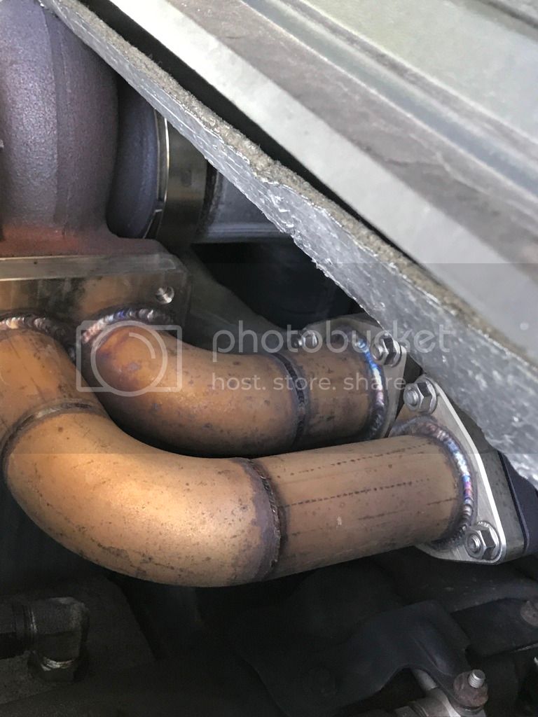

Unhooked the trailer and got it warmed up ready to make a pull and this happend...
Weld broke, sounds like 5.4 triton v8 that needs manifolds makes almost no boost, 8 month old mpd kit

What pipe is that
Part of the single pedestal, up pipes connect to it. And up pipes were replaced at the time of install for no reason other then they were old they were 100% still.

Are they going to fix it
I hope they are sending me a new one, but i haven't heard anything.. I called they said send pictures, i did, followed up at the end of the day and they said they were still looking them.... as of now i'll be out a 2500 dollar job i was planning to do today and tomorrow that i can't do because that truck is down, ****ty situation...

The good news is it looks like mpd is sending me a new pedestal and it will be here tomorrow so it should be back on the road thursday some time.
