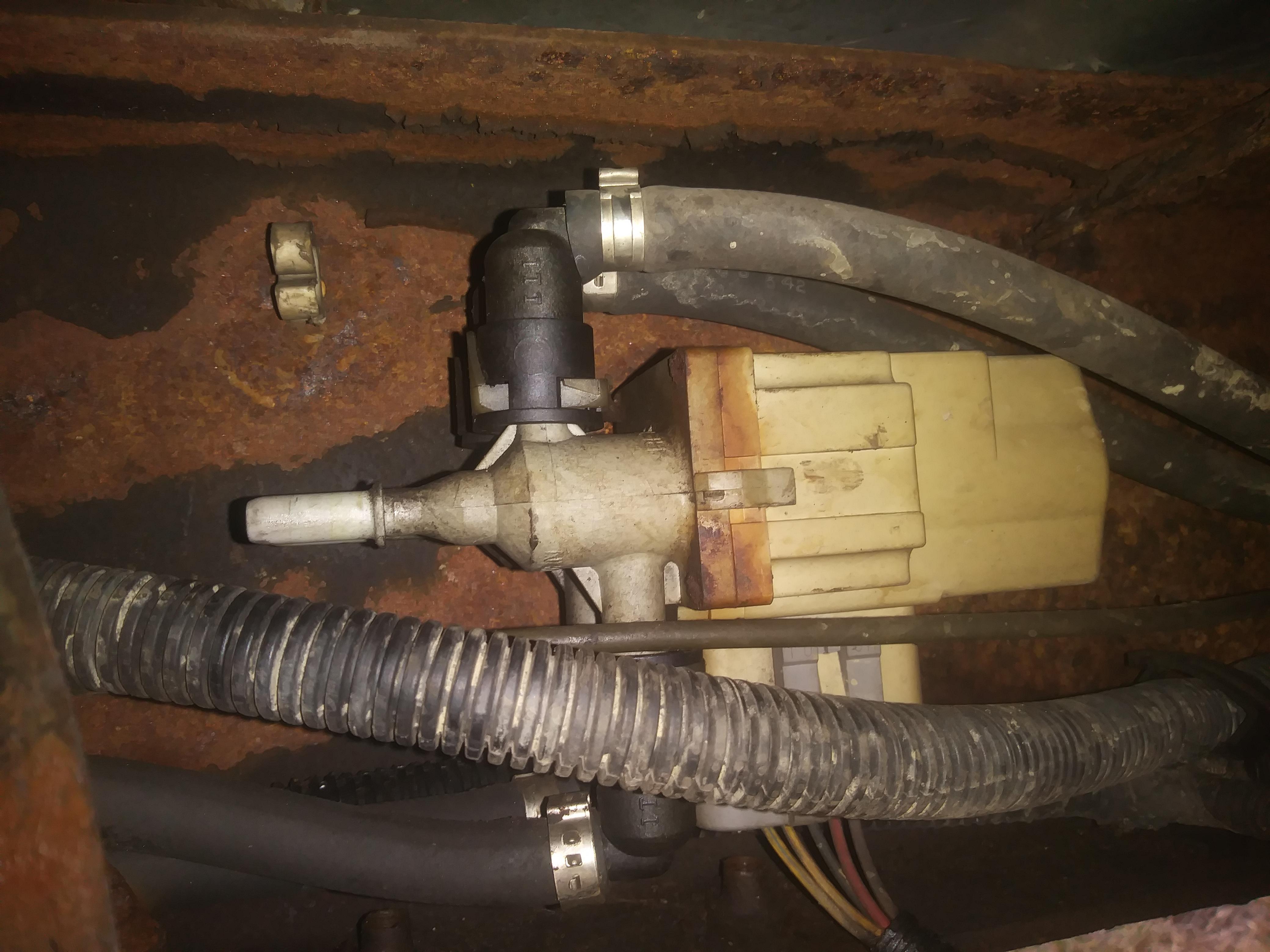

They will run on pretty much 0 psi. Frickin hard on injectors though
My selector valve failed between positions, and had me scratching my head for a bit before i figured it out.
No pumps in the tanks. Is there fuel in the valley? The valley pump has a weep hole that'll tell you when it fails.
