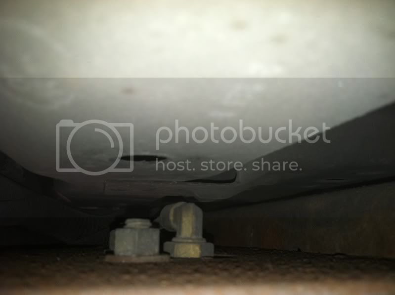

here is a picture looking up first you see the bottom plate then the bag then the top plate. On the Excursion, I welded the 1/4 plate to the frame since this doesnt use a Turnover ball system.
Here is a little closer up of the top plate, I just sheared a piece of 1/4" plate then put a radius cut in the front so it wasnt flat and pointed on the cornners and then bent it on the break 90 degrees. If you have a turn over ball system, you could weld this bracket on the outside frame plates if you want, or you could cut an additional piece of bar stock say 3"x10" and drill 4 bolts through the bar/outside hitch plate/frame I have done it both ways, but drilling through 3 pieces of 1/4" steel 8 times is a PITA..so I welded the bracket on my last hitch plates. Works GREAT!!
Top View-I just drilled a 1" hole for the air fitting and a 7/16" hole for the top bolt.
If you would like any other pic's just let me know.

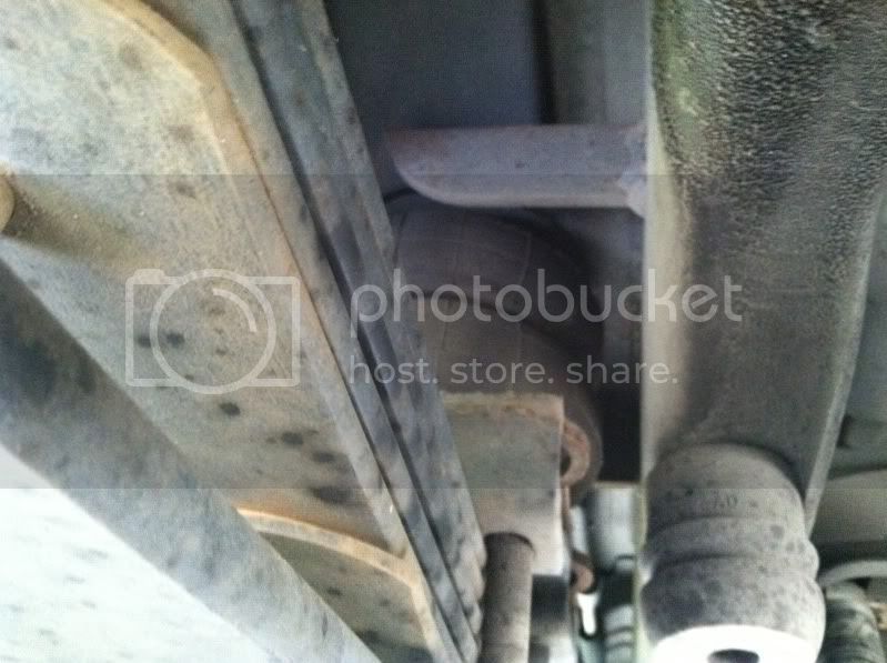

Since my truck's lowered and no kit is offered I went to NFanus Air Suspension in Mansfield.
They did quite a bit of fab work and put them on the inside of the leafs, I'm pretty sure that's were the semi's have them.
I'm with delmar the inside guage and switch it is def. worth being able to monitor air pressure in the bags and tank as well as adjust the ride and hieght by a switch.
The bags they set me up with have 150psi max, but since the compressor can only put out 120psi I think I'm pretty safe.
With the air and new KYB Monomax shocks, I love the way it rides now. Plan on beefier sway bars as soon as I can find a good place to pick some up.
