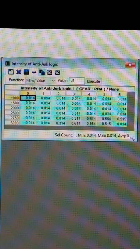

Hey guys, having some bucking/jerking happening in gear 2 and 3 when in lockup at 1500-2000 rpm under light throttle. I'm guessing related to the Anti-Jerk intensity table. Anyone know how that table works or adjusted anything with results? Also I see that the Anti-Jerk is set off under tow haul, curious why? Thanks

I messed around turning that off and changing values and never noticed a difference. on mine it would occasionally buck under light throttle.

I've loaded a tune with columns 2 through 6 set at 0.500, haven't had a chance to drive it but I'll post back with findings. Thanks for the response!

It did seem to make a nice difference. Set all columns under 2nd through 6th gear to 0.500 and seemed to smooth it out nicely.
