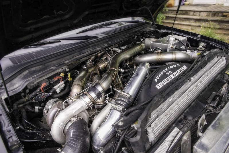

Looks good, but a piping nightmare. LOL
NICE
Let me know what you find. Ive found after many years, that checking and fixing your basic stuff will usually fix the problem or make it stick out even bigger.
It was a nightmare for Jordan to figure all out... But it takes only a few minutes and everything can be removed.
Keep them coming! Looks killer. What's the box looking thing under the hot pipe?
I am sure it does, I was just talking chit.![]()
