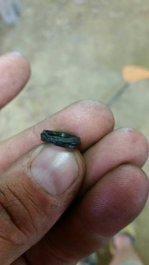

6speedsd
Jun 9, 2011
3,468
Olive Branch, MS
Top of an injector is where I'm expecting to see it honestly. At least that's what I'm hoping for. Air was "louder" out of the passengers side, so might pop that one off first since there's less to remove first.
Drove it today. Turned over 3 times this morning and fired. Got to work, shut it down, and back to hot no start. Did a long crank, and it never built enough to fire. Truck sat for almost 12hrs before I cranked it to head home. Was slow building, but fired after maybe 7-8seconds.
6speedsd
Jun 9, 2011
3,468
Olive Branch, MS
Well there's your problem. Could hear it leaking here before I ever actuated IPR. Upper seal on #8.
