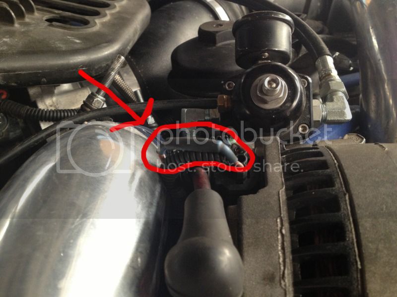

Well, went to change the alternator and think I found my problem. Looks like it is indeed the fuse or whatever it is on the alternator plug. When I went to pull the plug off the wire came right out of it. Does anyone know what it's actually called or have a part number for it?
I put the wire back in as far as it would go and electrical taped it in place to see if it would turn the light off and it didn't. Went ahead and changed the alternator too and everything stayed the same- it's charging the batteries even with the bad plug wire but the light is still on.
This is the thing I'm talking about:

How do those connect? Looks like it's just heat shrink tubing on the outside. Would I be able to cut the heat shrink off and reconnect the wire?
imelmo
6,632
It looks like it just pulled out. I'm gonna cut the heat shrink off and get a better look.
imelmo
6,632
Well, finally got it taken care of. Turns out that is NOT a fusible link. After looking closer, it appears the plug was replaced at some time or another and those were just butt connectors in heat shrink.
What exactly does that wire do though, since it was still charging even though that wire wasn't connected?

Judging by your light, it may be the r-terminal(run terminal). It shows that the alternator is putting out power.
