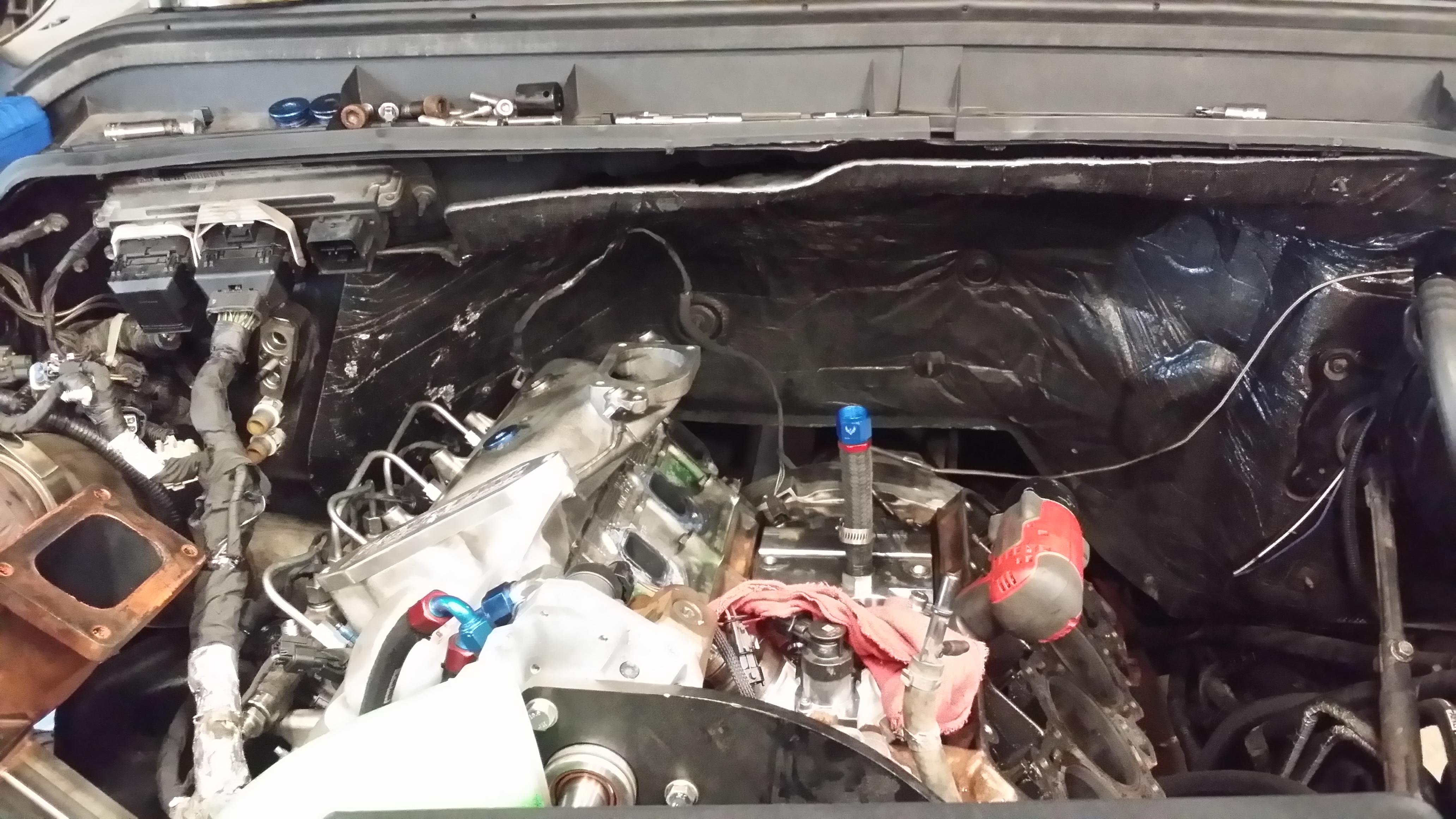

Ending the night with one head on hoping to end our journey for that 9 sec pass this weekend with a few little modifications we have done

B585Ford
Mar 17, 2012
2,730
WV
Good luck. I would love to see this thing get in the 9s on fuel only.

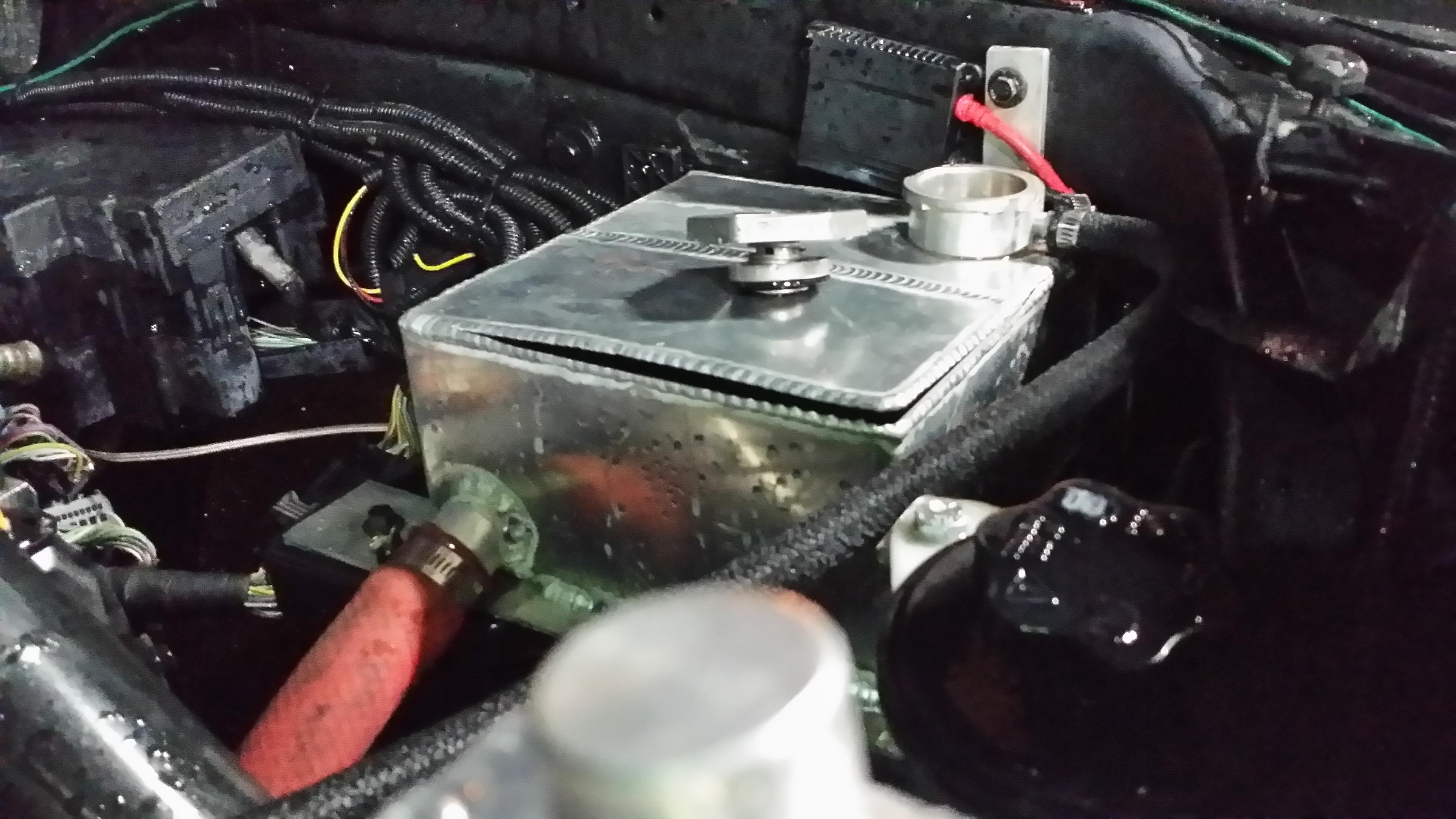

Just leave this here after the new gaskets....
Craig@MFI
2,184
1.5 passes on this set of gaskets we tried arps this time not gonna say it is there fault completely yet but we had 100 passes on our h13s and never blew this bad

Where did the gaskets fail the first time, when the factory bolts were put back in?
100% studded now? That's a bummer.. Held better with the stock bolts thrown in the mix lol. Hate to see it Craig.. Hope you guys give it another shot before putting it away for the season.
Craig@MFI
2,184
This time it held worse than the h13s and the 4 top stock bolts I'm not pointing finger yet but I would find it hard to believe the block is cracked
Dzchey21
11,784
wyoming
Thats crazy im with shone i would have thought a hose would have burst before that.
hopefully its not the block, personally i wouldnt be surprised that thing made some power for a long ass time
