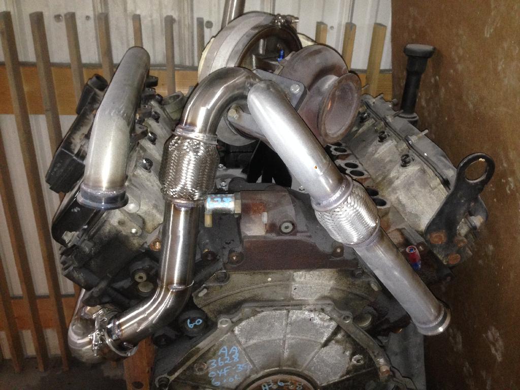

I did get the turbo sitting in it's place last weekend

Had them cut at my college, on their water jet while I was there finishing up my license, it was a full flange but ended up cutting them into individual piece because of fitting issues

All done the fitting together part

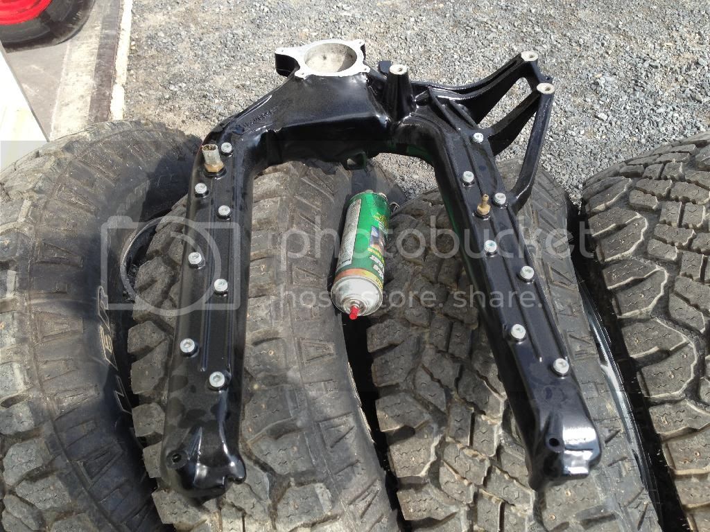

Yes it does. Running a custom intake setup too I see?
Huh? Are you seeing the passenger side manifold sitting up there?
Yea I think that's what he seeing, in the first pic Mdub? That would be the passenger manifold

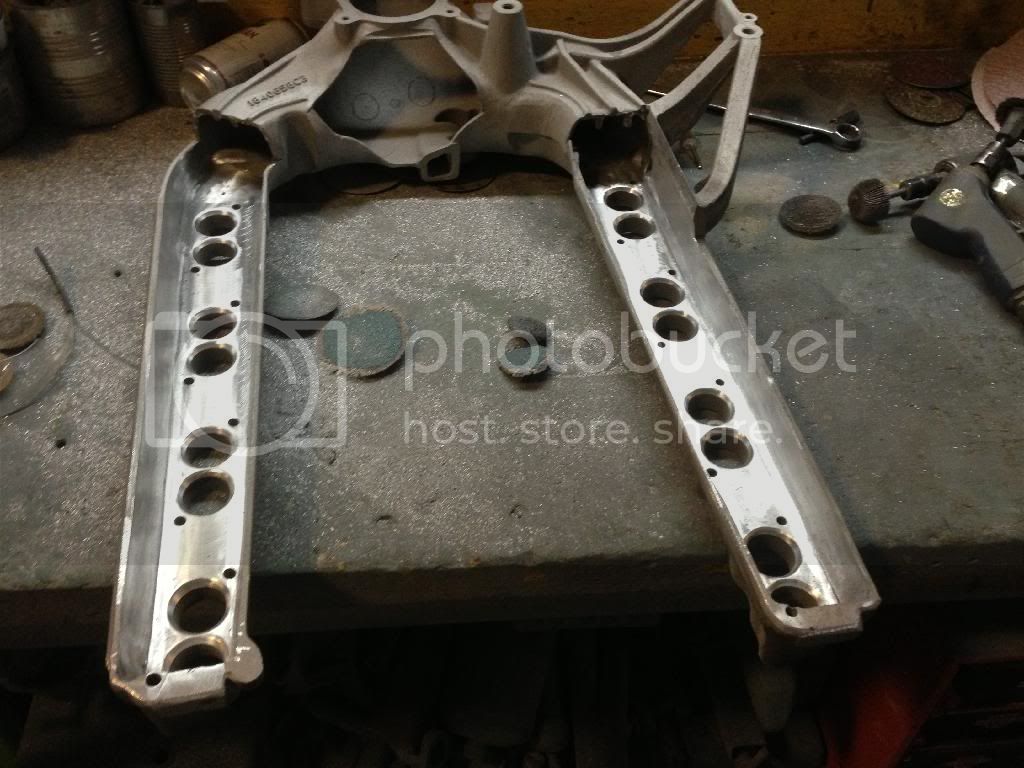

I did port my intake manifold last year tho

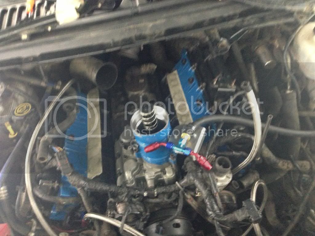

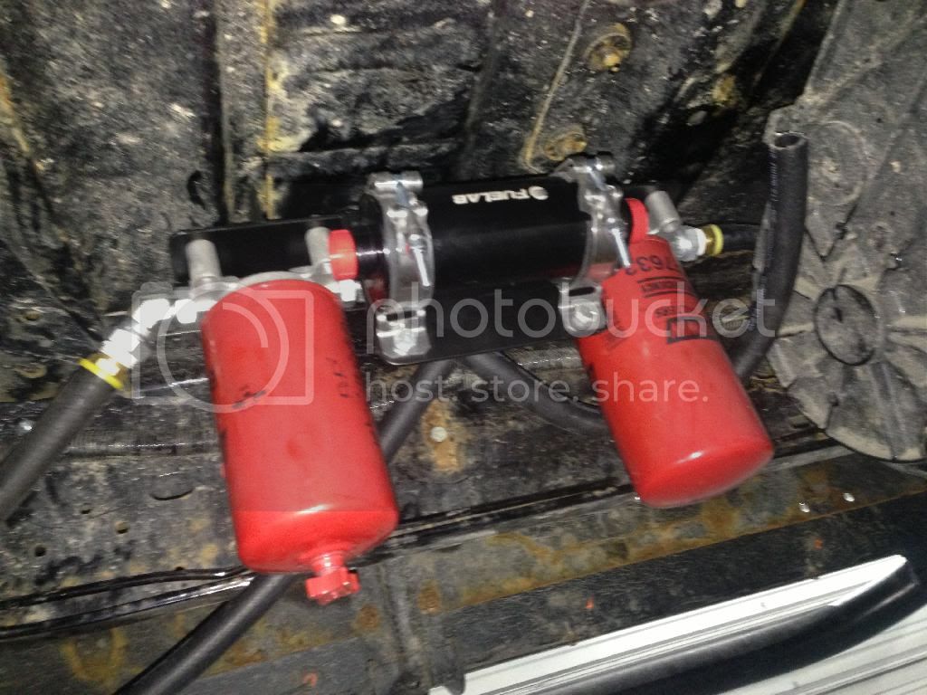

And I build a fuelab fuel system for it last year also
