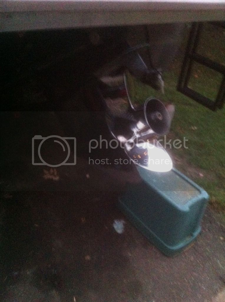

Picked up a nice 4 blade prop off of CL this week for 100 bucks.

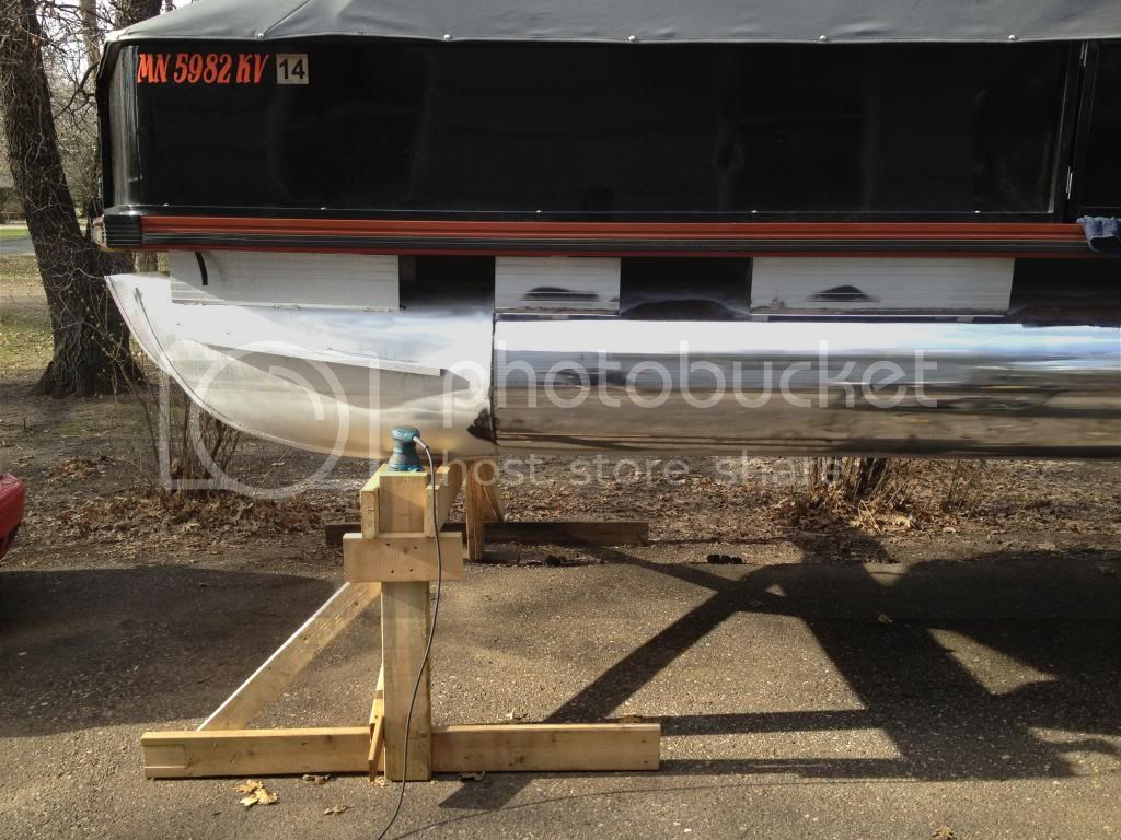

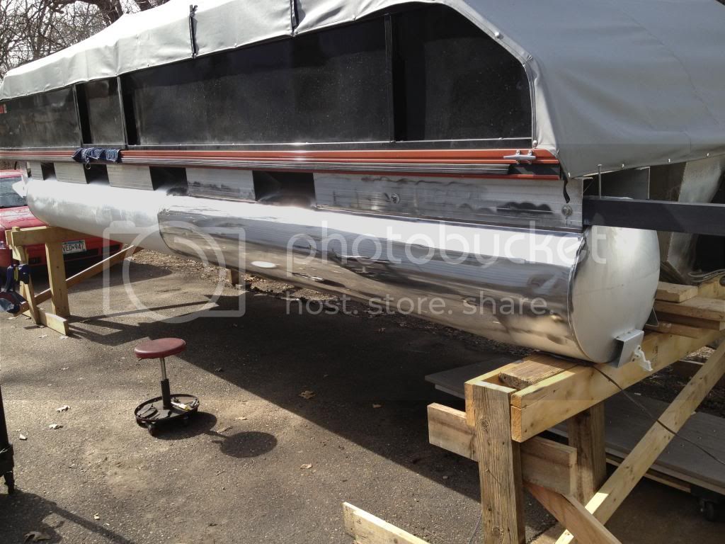

Thought I would do a quick right up on polishing my pontoons toons.
My boat is a 89 Bass Buggy that I complete restored last yr.
(http://forums.iboats.com/completed-boat-projects/pontoon-conversion-inboard-outboard-573089.html)

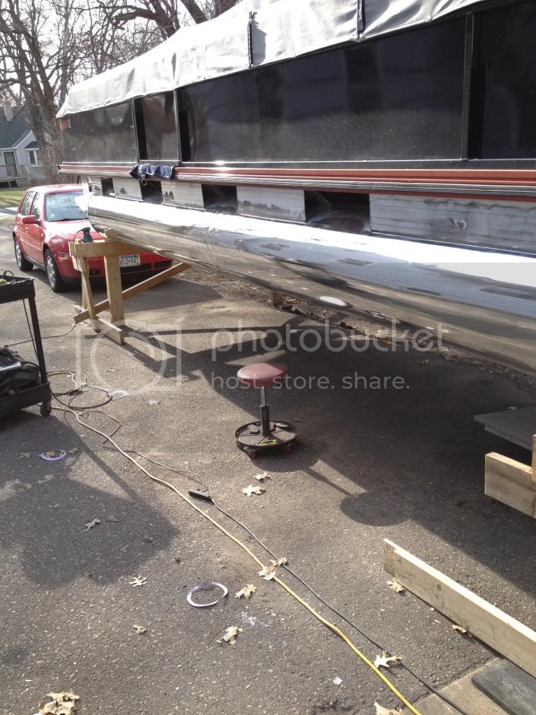

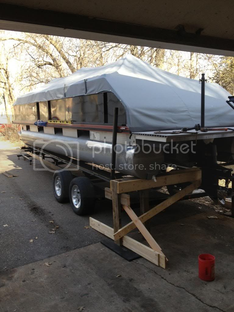

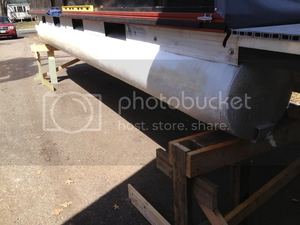

I first started with getting the boat off the trailer
Then I used some JJV’s pontoon cleaner. This stuff works awesome even on my old boat it took all the scale off and brought them to a nice dull finish. I went over each toon twice and I used a little less then a gallon. Well worth the 30 bucks.
After it dried I sanded the entire toon (everything I wanted to polish) with some 400 grit sand paper on a random orbital sander.
Next was onto the fun and dirty part. This will back your arm feel like jello and cover you head to toe with black dust. I wore Ear, Eye, and respirator for the first half and will be switching to a full face shield for the 2nd half.
I purchased all my polishing products from here. I had the 6” grinder that I use on metal so I didn’t need that.
http://www.buschshineproducts.com/aluminum-compound-kitshand-held-buffer-p-137.html

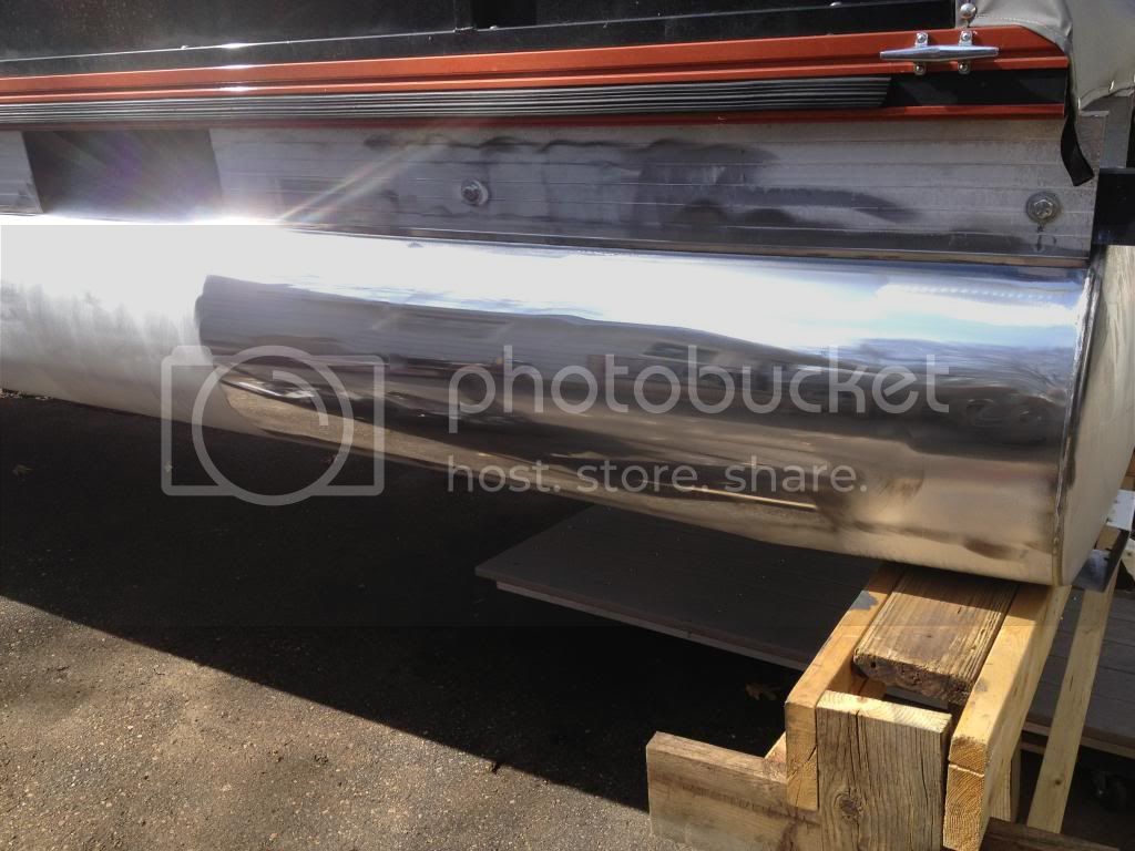

Started with the Yellow pad and the Brown Bar, working from bottom to the top of the boat. Stopping every 16” to clean the pad and apply more compound. Very important to clean the pad every so often as it will get aluminum build up on it and actually scratch the toons.
Next was onto the Off white pad and white bar. This brought it upto where you see it now.
I did all this in about 2hrs (sanding and the 2 polishing)
Next step will be a final polish then a quick hand polish. All said and done I should have 10hrs into both toons front and back and the sides.

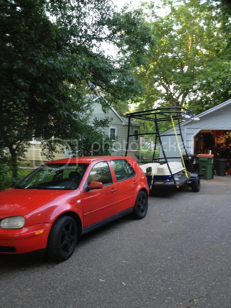

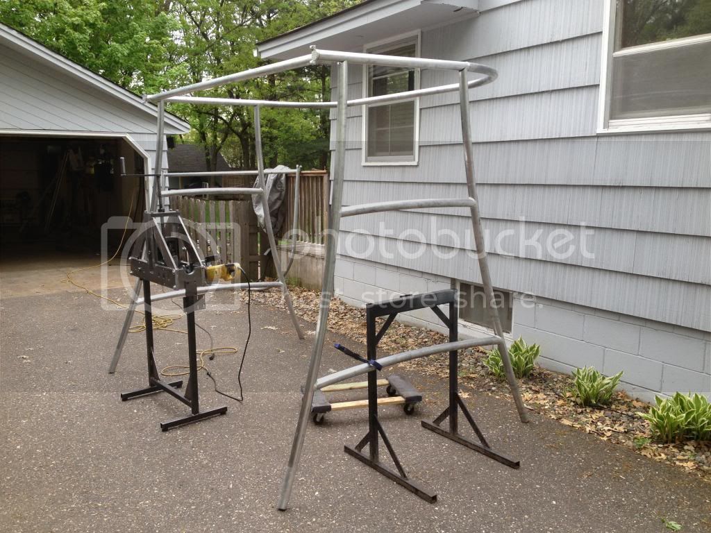

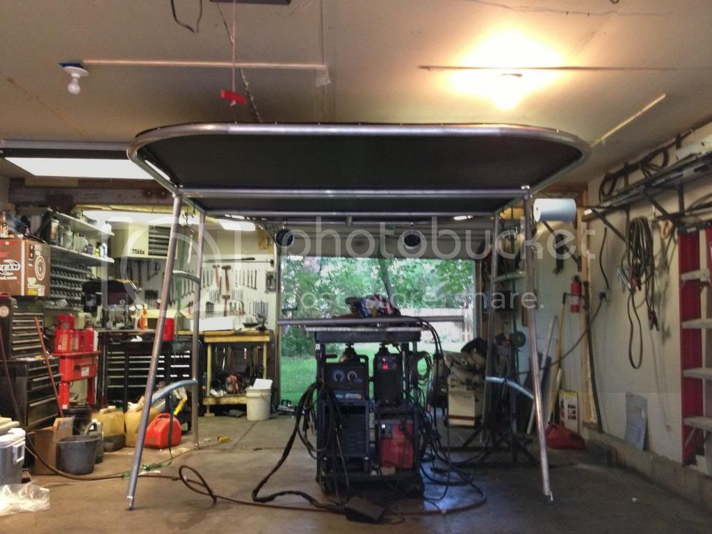

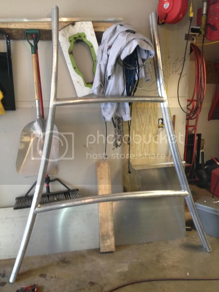

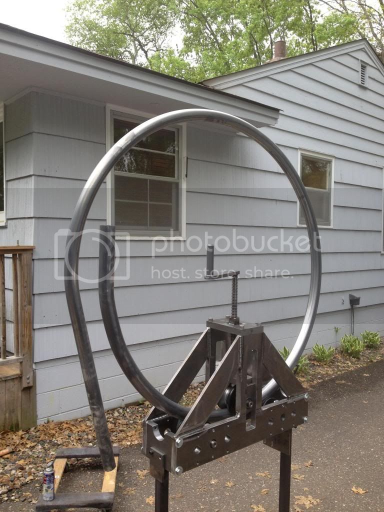

Need a new Bimini top as the old one from the boat well was old. Also wanted a wakeboard tower and a place to hanger speakers also wanted nice rolled tubing. Didn’t want to spend a arm and a leg on a bender so I made my own. This was the end result. Some pics of the build and the end result.
In the garge all welded up with the speakers and top on. Right before paint.
A week before memorial weekend the Wife and I closed on a cabin 2hrs north of where we live on a nice lake. Since then the truck and Boat stay up there. Instead of driving the truck home I use my car and trailer to bring the tower up.
Tower on the boat. Really like the way it turned out. I can pull to pins on the top and the bimini goes from 8’x12’ to 8’x6’. From there I can pull to more pins on the bottom and the entire thing tips back and the speaker rest on the swim platfourm.

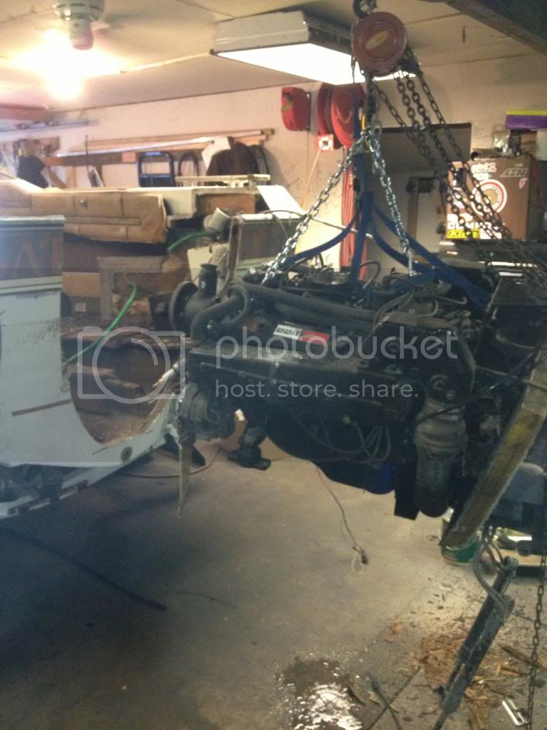

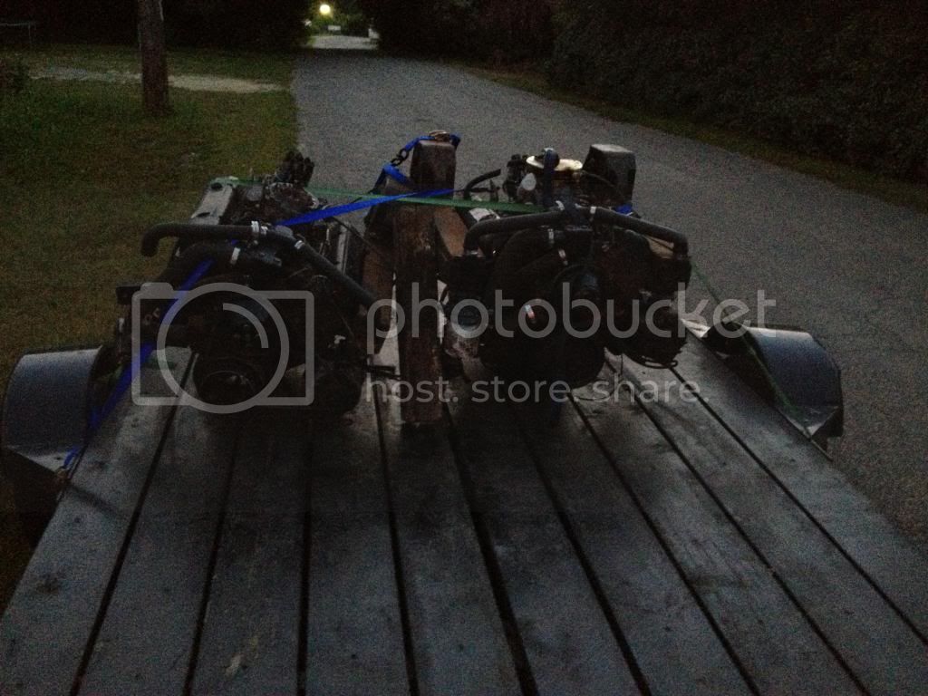

Over the summer I kept my eye on CL for a cheap v8 boat so I could take all the running gear off the boat and install it in mine. (really wanted power steering).

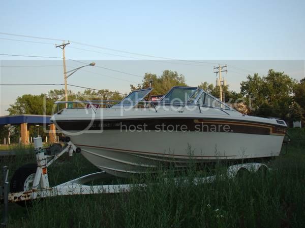

2 weeks ago I found this on CL the lady said it ran put need a floor. She was asking 1k for it. After looking it over it had a cracked block outdrive was shot but everything was there. Gave her 200 bucks for it.
“removed” the motor the easy way.
Sold the trailer two days later with the boat on it for a grand. (800 dollars profit) Once again I looked on CL for a cheap motor and ended up finding to 5.7lSBC out of a house boat gave the guy 200 bucks for them.
They hadn’t been run for a while but compression checked out OK. My plan is to get one running and sell it off and then rebuild the other one. Running marine SBC go for about a grand around here. The 2nd motor I’m thinking alum heads and intake a nice marine cam and call her good. I also im going to install a 3rd pontoon that goes all the way back to the motor pod along with lifting strakes on all the toons. I’m pushing for 50mph out of her next yr.

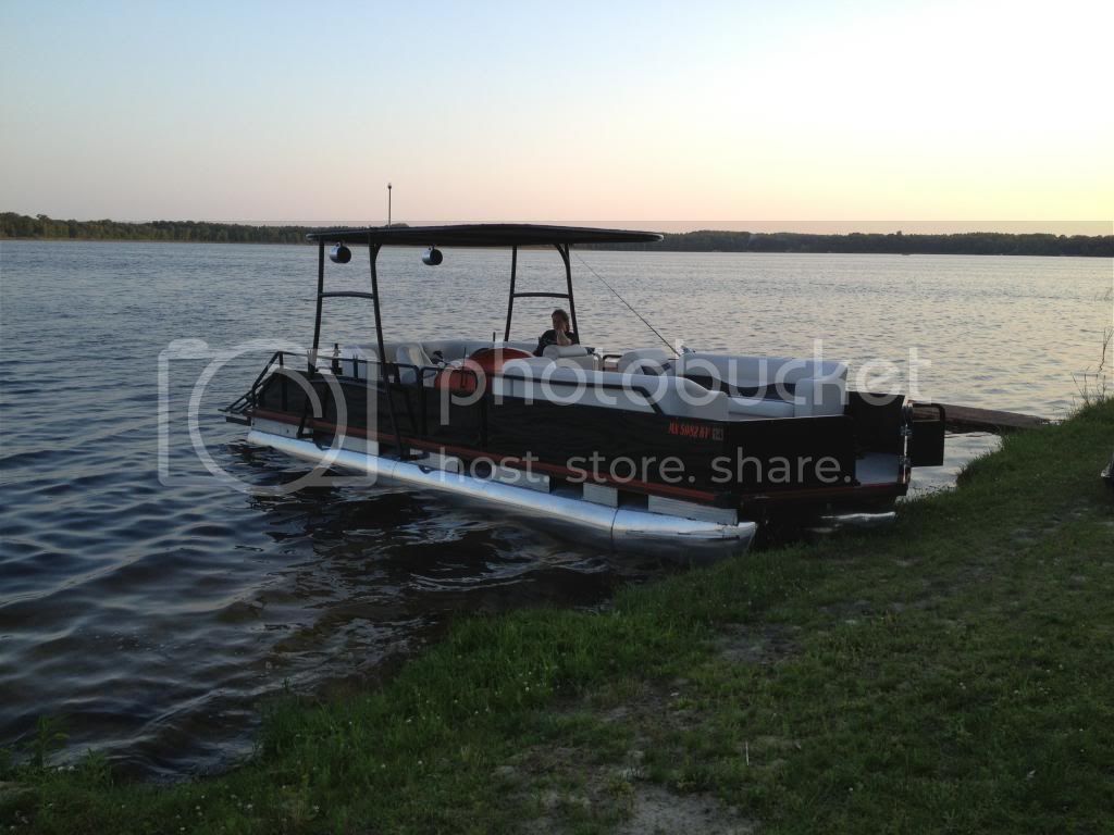

O yea some pictures of the boat on Labor Day weekend this yr. 700 people on a sand bar with not a cloud =good times.
Wife infront of the boat.
Friends on the boat.
