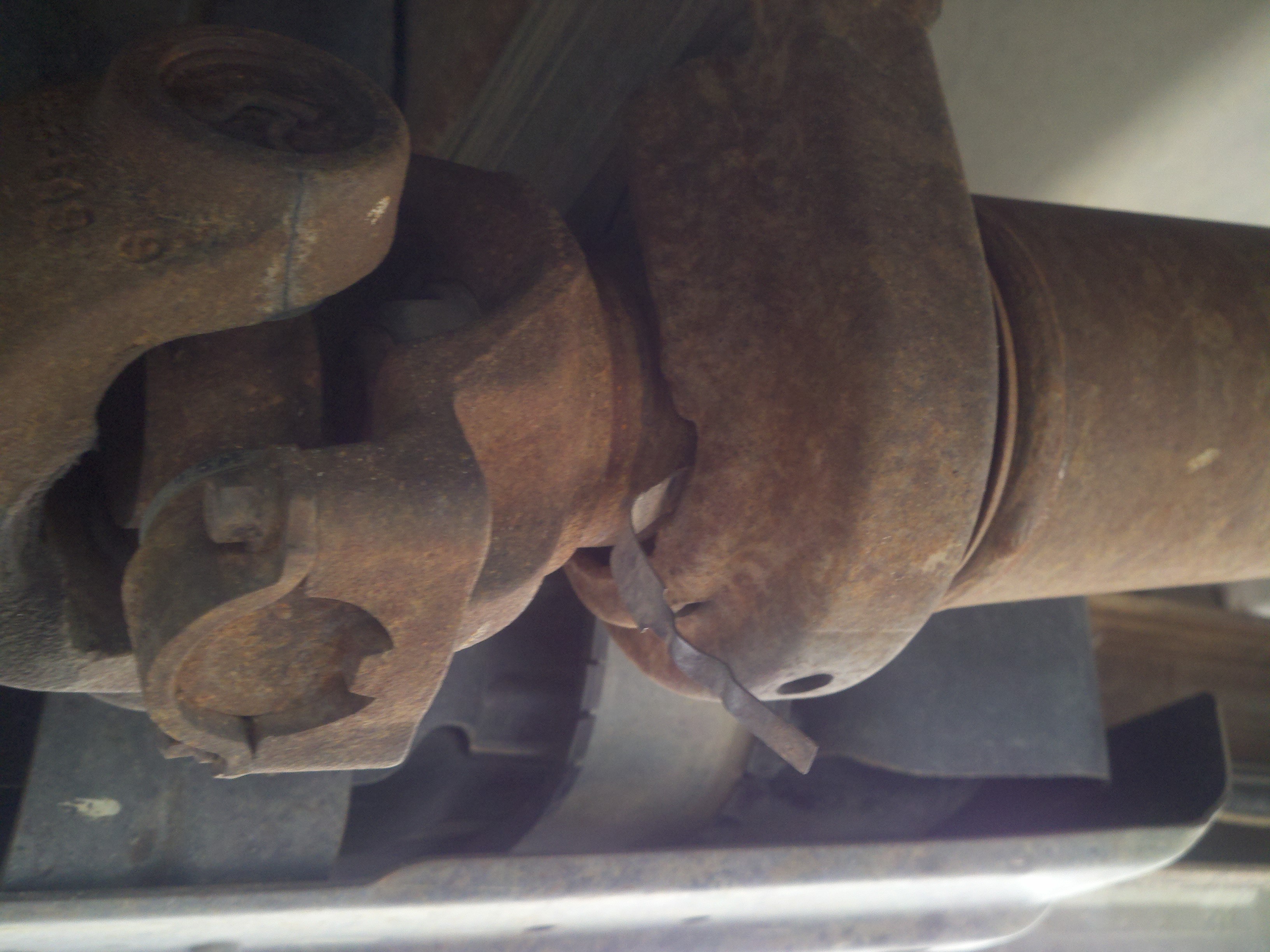

Called two local drive train shops and got quotes for about $80-125 (depending on cost of the CB) to do the replacement. That's with me dropping the DS and taking it to them, which I will do. Considering the labor is less $50, I can't really "afford" to do it myself. :shrug:
Considering I don't have a press or cut-off tool, seems like a no-brainer.
TyCorr, I see what you are looking at. I'll take a closer look, but I don't think it is. Thanks for pointing it out!
Yea just take it to the drive shaft shop.. Takes 10 min for them to do it.. I had them do the center bearing all new u joints and balance. All spicer long life parts for $250
Amazing how much smother it was under acceleration.
hey scarlet, did u do that driveline carrier brng yet ? I hope not, cause that little piece of tin tape is there to keep the rubber attached to the bracket while you mount it to the crossmember..... you might wanna drop the line and check that brng before you replace it......
if it's rough, yeah, but if it spins smooth, don't bother....
