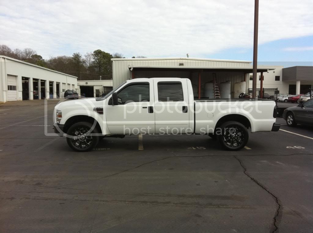

So I pulled my lift off my truck, I have the 6000lb srpings in it with the add a leafs in the rear and no block it sits barely higher in the rear I might keep it this way.. how much lower do the 4800 coils sit
Jeff@Spartan
5,409
Georgia
This is how my truck sat with the 4400 lb springs and no rear block.
