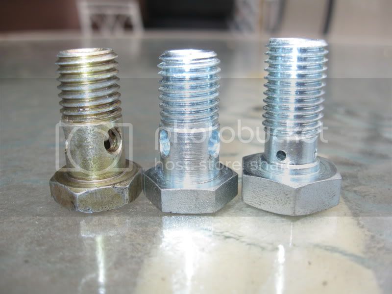

I'm using banjos on mine right now with those stainless lines bud.
Don't forget the heads can be put on either side, meaning the front is the same as the back, so if the banjo bolts up in the front, it will bolt up in the back. It has to.

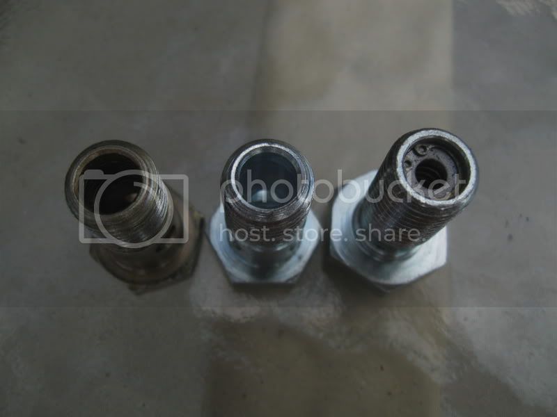

Here's some pics of different banjos.
From left to right, Ebay large 3 hole banjos, the middle is the banjos supplied with the vegistroke kit, meant to go in the back of the heads, far right is stock 6.0 bolts.
