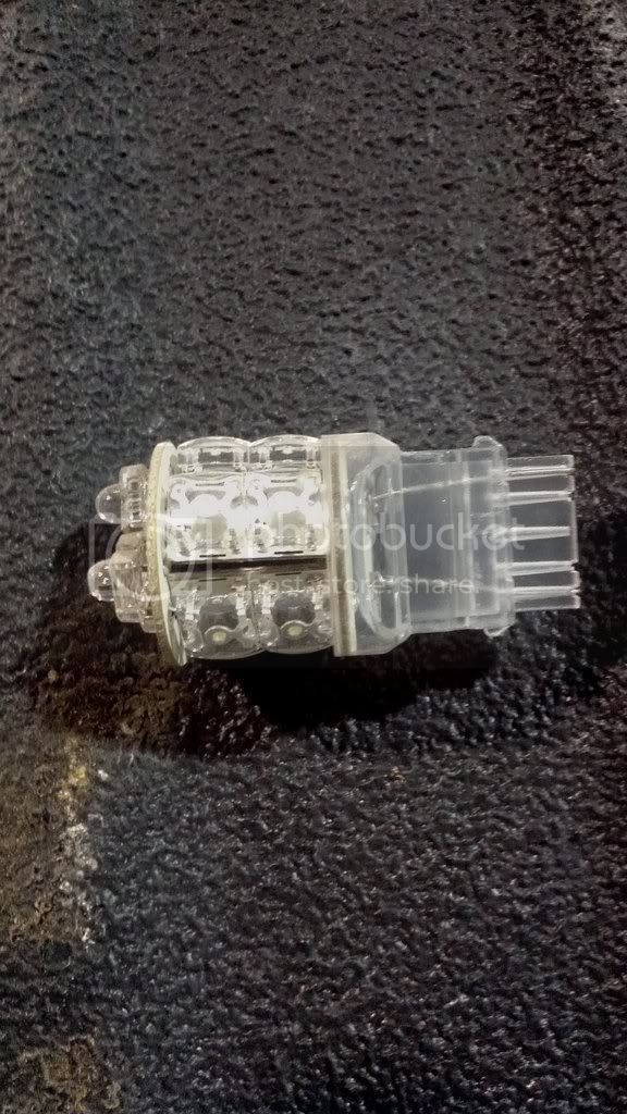

I recieved mine a while ago. Did't put them in cause my truck was in a shop. When I did they don't fit. My connection is way smaller and no way for these bulbs instal. My connection is the type that cw96stroker posted. I have a 2008 F250

This is the type of connection that mine seems to take. I have a 2008 F250 and when I went to instal them I noticed that the Cree is much bigger and can't instal in what my truck has. I had some bulbs somewhat like the ones in the pic and they fit.
This is what it looks like
Thanks to Ford, the bulb type for your model year is incorrectly listed in all public databases (and probably that owner's manual too!). Both, the correct and incorrect bulbs are wedge style bases, but different in width, thickness, and length. You would need a smaller 921/T15 base style to fit yours.
Please EMAIL us in reply to your order confirmation email so we can help you exchange those to what you need!
