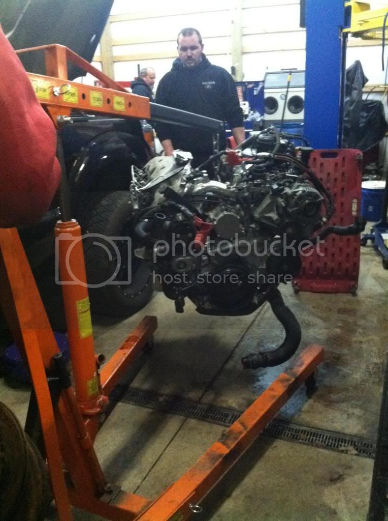

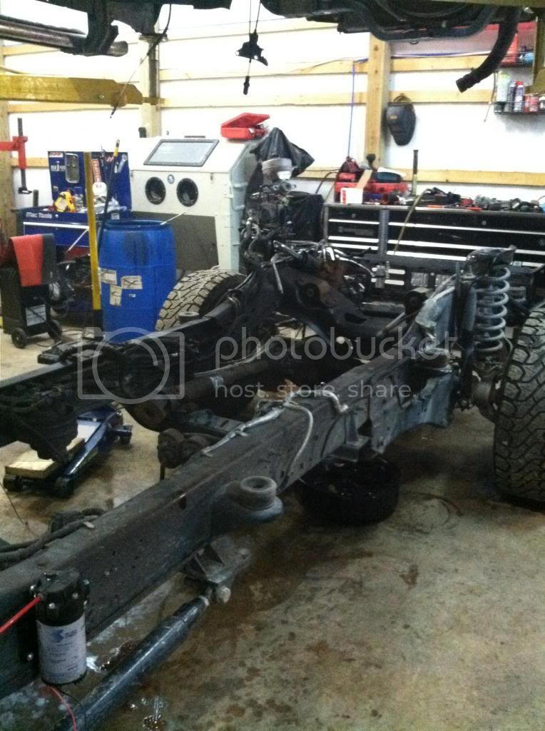

Engine's out
And so is the trans...
Now let the fun begin!!

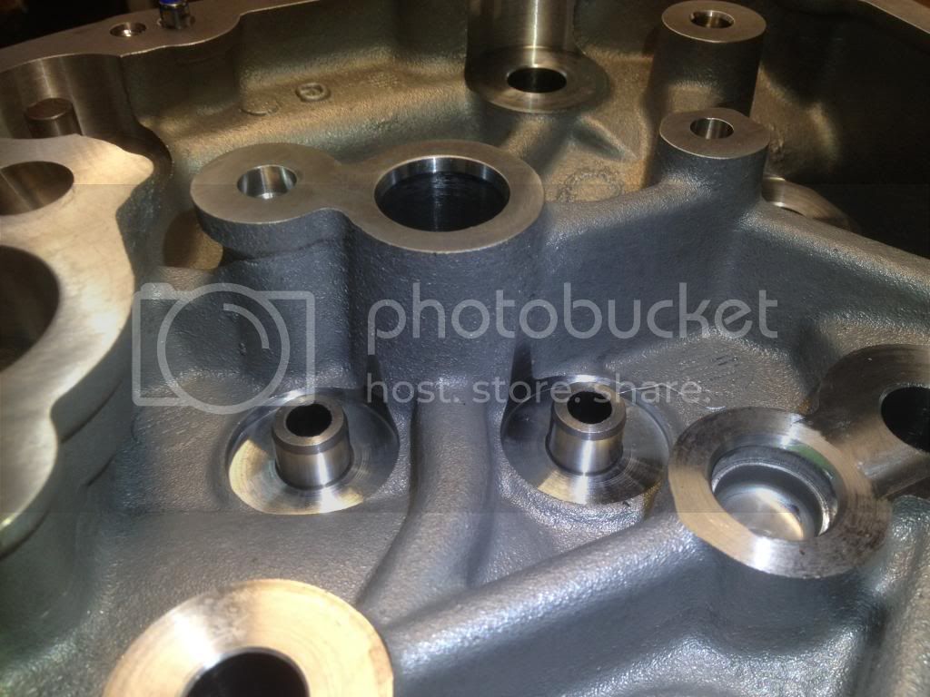

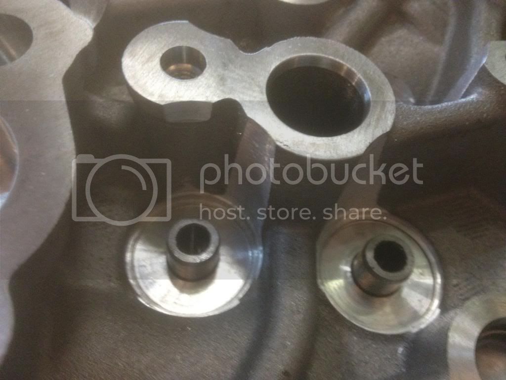

Here are some pics of the machine work involved in running SPE's monster valve springs on Matts heads. Lots of nitrous and boost want faze these..
Stock
Machined head
