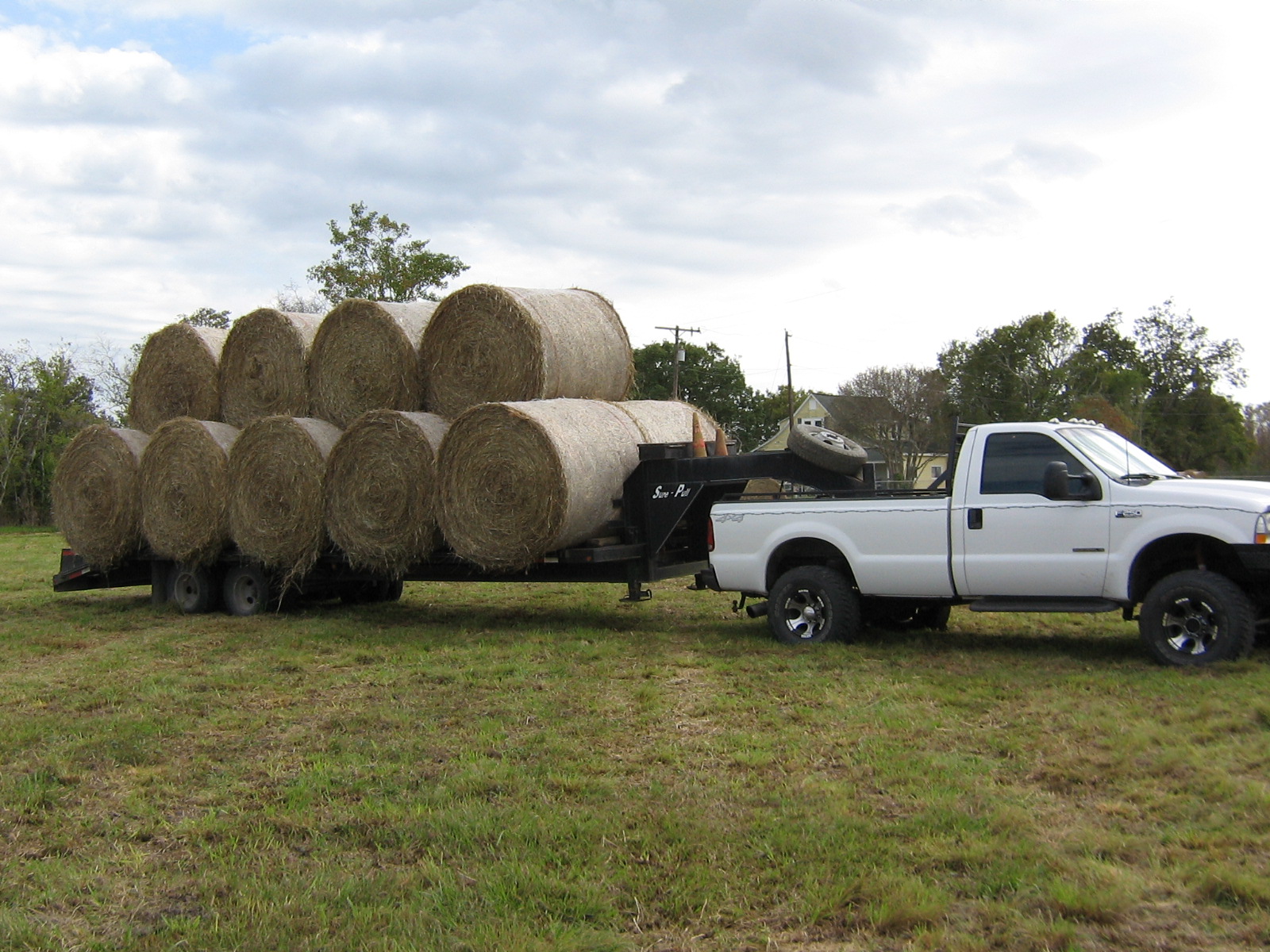

Would you pull any of these with your Hot tune? I dont know the weight. Alot though...
This was with 238/80's, 38r, Auto, pmr motor. I like my heavy tow tune... I can almost guarantee you that you will have some EGT issues in a HOT performance tune with any of these. So yea, I like playing with my knob... LOL

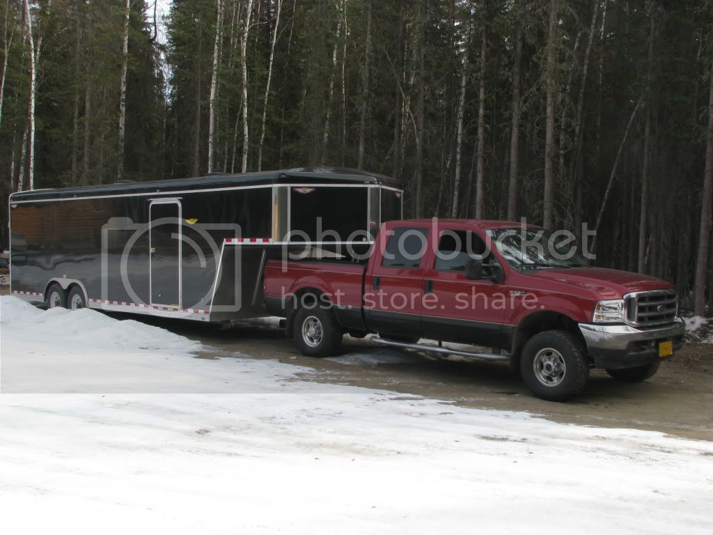

I pulled this in my "do it all tune", 300/200's. Roughly 14k.
The only reason you have high egt's is you are either overfueling in relation to throttle input and rpm's or your PW and timing is way off. Period. Your 80% nozzles should run cooler than my 30% nozzles. Curtis does the same with 250/200's.

Yes..... I have towed a 40 ft gooseneck full of square bails.... It's all how you drive it man... Never towed at high elavtion though...

That's bad ass non the less. With Twins?
Yep. And for those who think they can tow heavy, try doing it at elevation with some steep grades....for miles on end. You will then understand how important tuning is.
