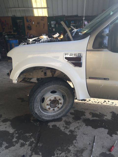

Hood fenders bumper header panel, running boards all removed

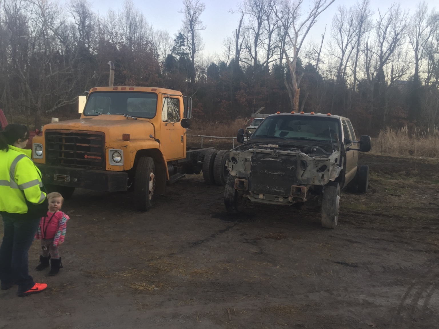

It almost looks like your wife is giving it that "are you serious?" look. Lol! Cute kid, btw. This is definitely going to be a sweet build. I like the fact that you are doing a 450 too. That way you can legally tow more too. If I was going to do one, that would be what I would put it in too. It just seems like such a waste to build something so stout and put it in a 250. I forget, what are you going to be using the truck for?
ken6881
Oct 8, 2012
429
Yes I am getting the u bought this look. It's going to be a Daily driver. But I buy and sell/ mechanic quite a bit so I end up towing a trailer heavy twice a month sometimes more often. I'm wanting to upgrade to a 35-40' gooseneck, but a house and land just came on the market in the perfect location for us so we might be buying it.
