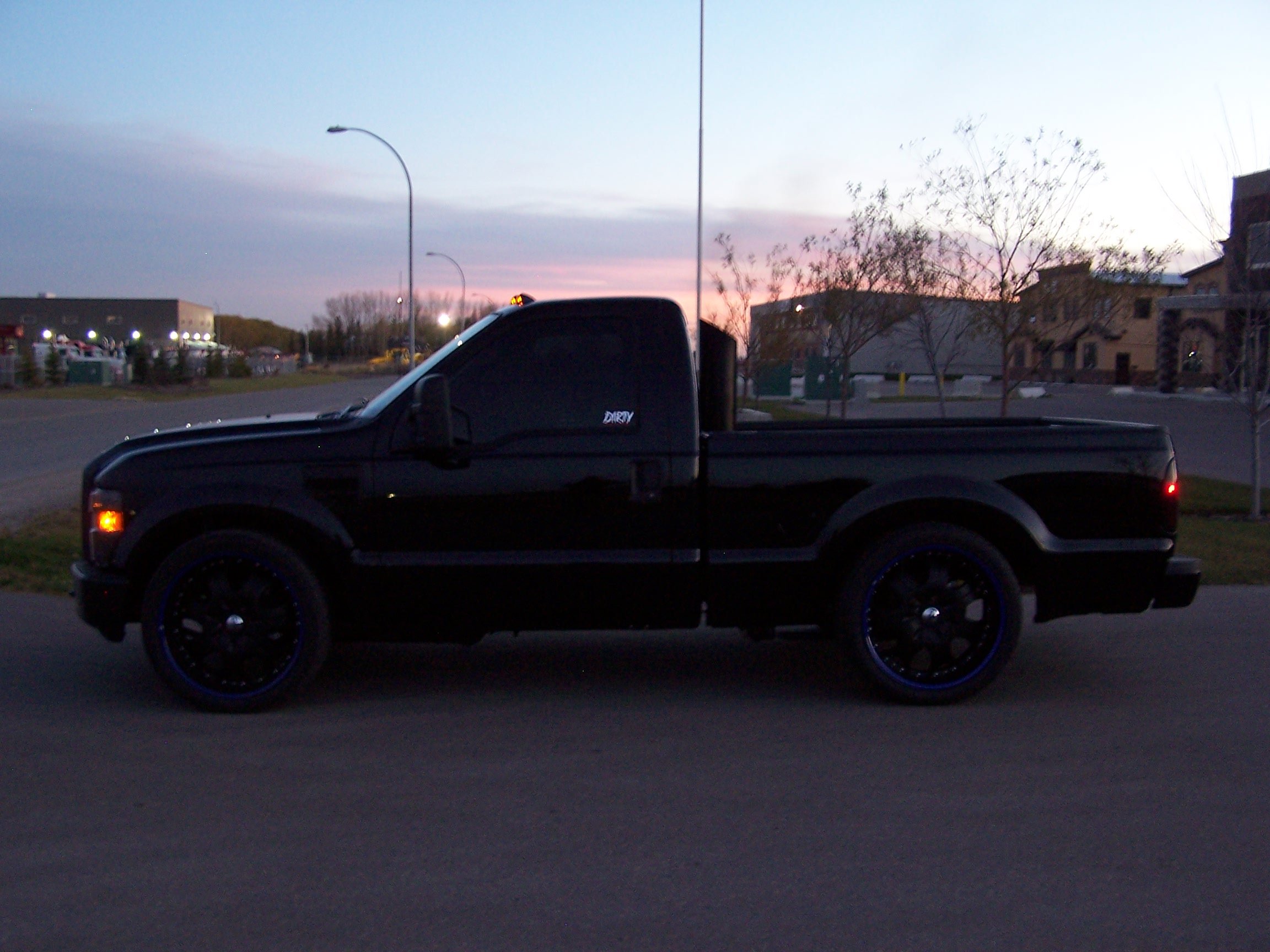

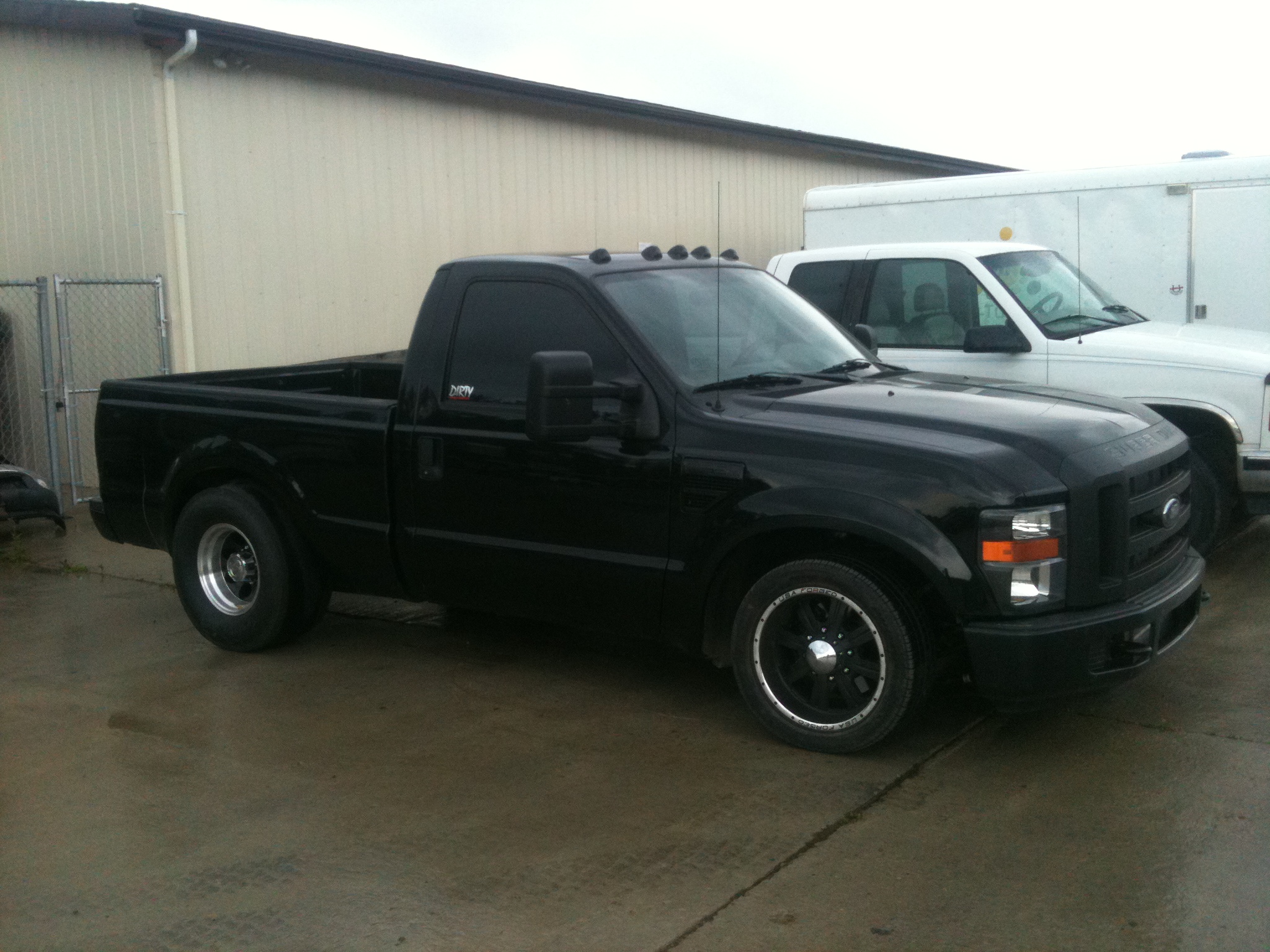

Not sure what to do with this truck
Got the cab up blew the exhaust manifold gasket out and both flexes in the up pipes.
Dont know if I should up the turbos I have to GTX35R and GTX4202 with bigger exhaust housings or start over with a ZZ fab intake and build something different.
My personality and small ***** says I should do trips but in reality I am not looking for more HP I am looking for better spool up so it is not so nasty on the street. I thought it was the manifolds leaking so i got a pair of Steed Speed manifolds and am going to use them anyways so there is less volume between the heads and turbos. The whole back side of the motor is gross from exhaust leaks and a HP fuel pump gasket leaking.
I dont know what to do but I dont want it sitting cab in the air in my shop to long its getting in the way already

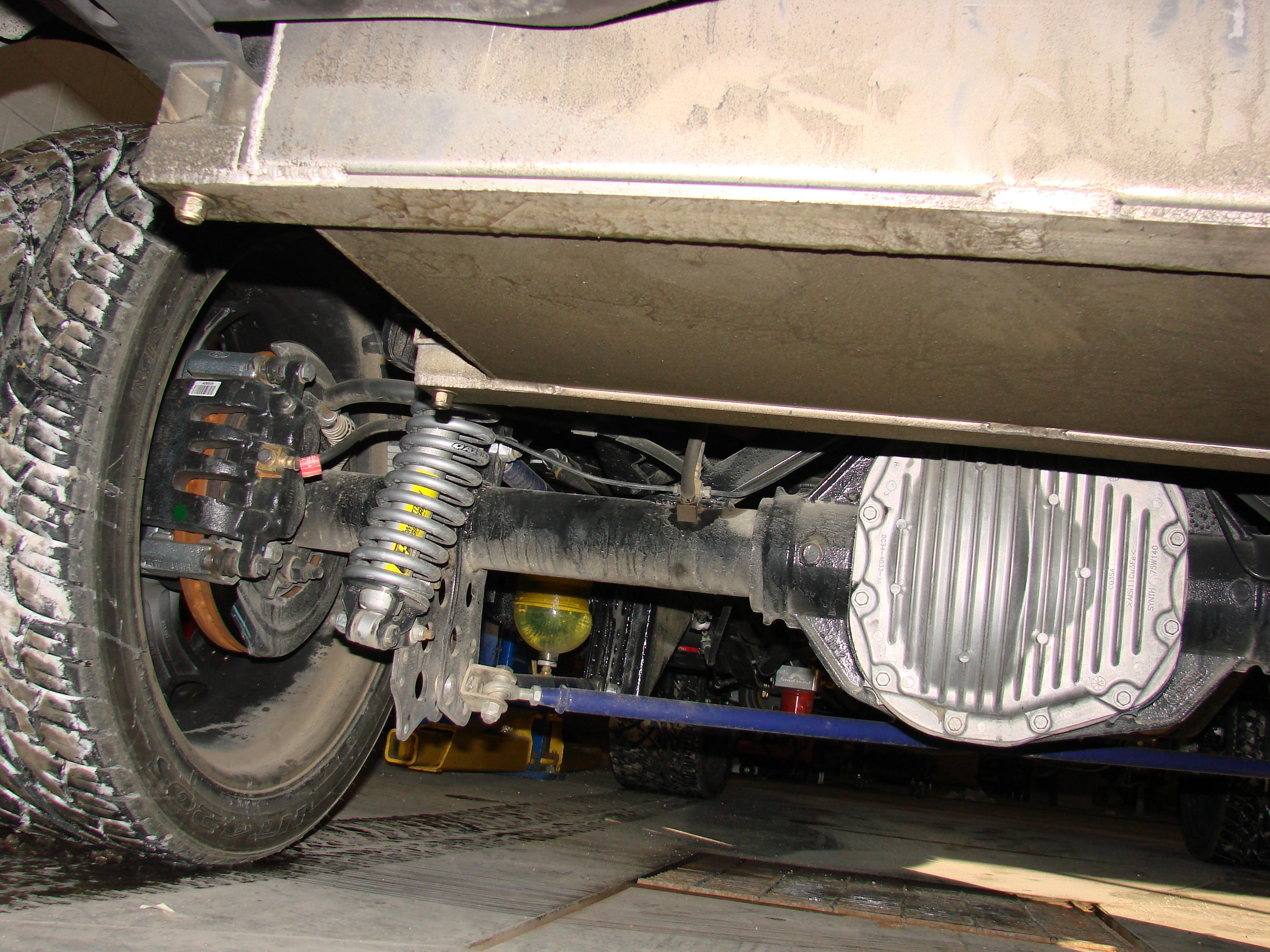

On a more serious note. What do you do for traction, and how well does it work?
11.1@129MPH with a 2.3 60 foot
I am trying but it is a work in progress. The truck still ways 6000 pounds
4 Link
Back dated brakes to 2004 F250 so I could fit a true slick and 16" rim
the truck tries to flip itself over need to change my spring rates side to side.
Need to drill the rims and screw the slicks because they are turning on the rim.

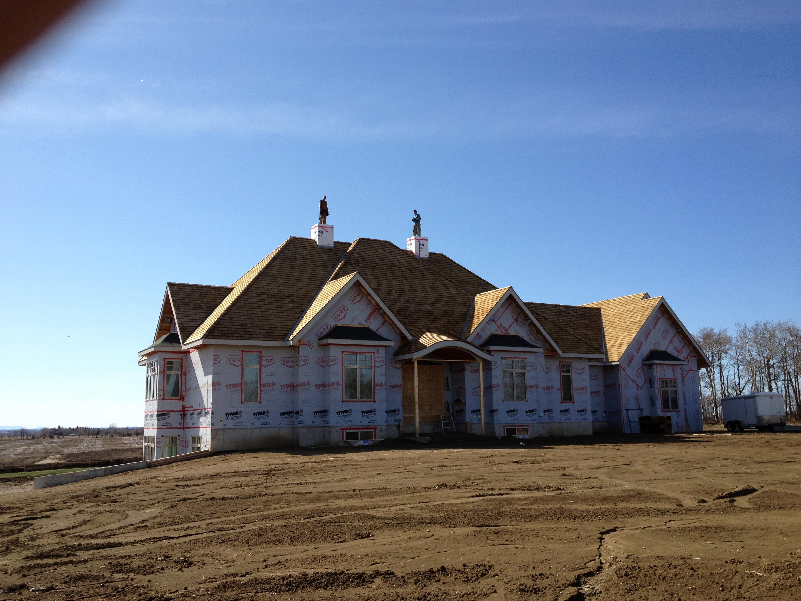

Thanks still building that new house and bought my business partner out from 24/7 Compression over the winter so really been trying to tame my diesel addiction however spring fever has caught up to me
Dr Smoke
Jun 23, 2011
62
probably another 6-9 months left

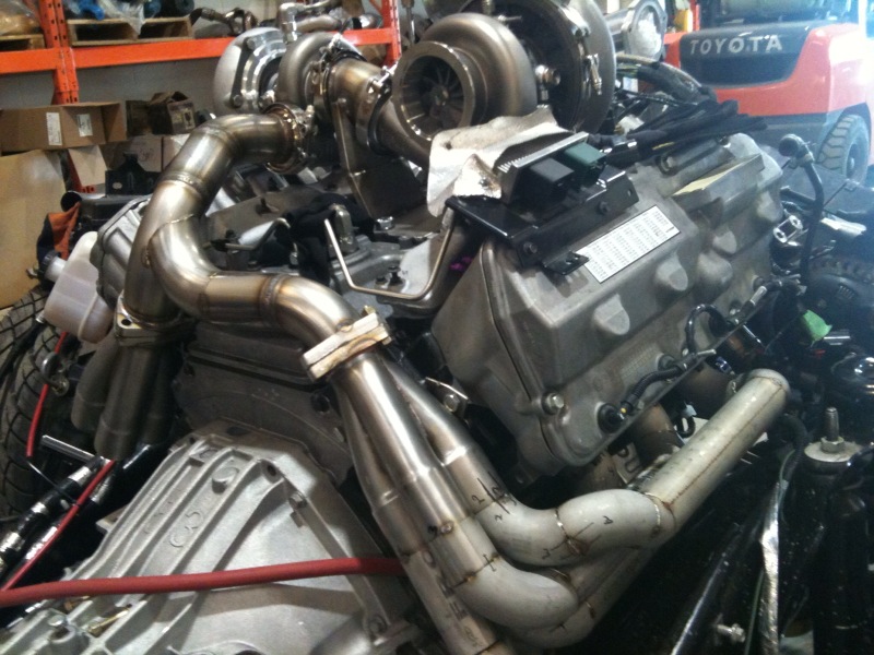

How responsive is it now? I'd have to look at it but im thinking You could drop down to a gt4094r and run two of them as parallel atmospheres on the 35...
Have not gave it a fair chance up pipes or gaskets are always blown.
Cole says his is fine with the same turbos. he has log style headers
