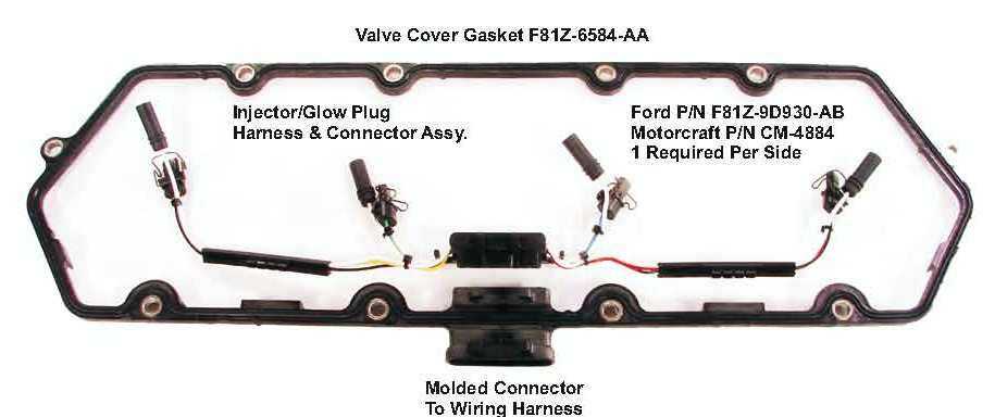

now you said both UVCH are brand new my question who did you buy them from? now i had an issue with a set that the gasket and the harness was one pice and when i plugged the truck harness into the connect it was not good. i ended up getting a set from ford that set from ford was the UVCH is separate and plugs into the gasket. can you take a picture of the UVCH so we can see what one you got .

joe, can you take a picture of your UVCH so we can see which one you purchased ?

if your UVCH does not look like this then you got an aftermarket one and most aftermarket products don't work as good

Thank you for that I will try. The UVCH are Dorman and are the two part.

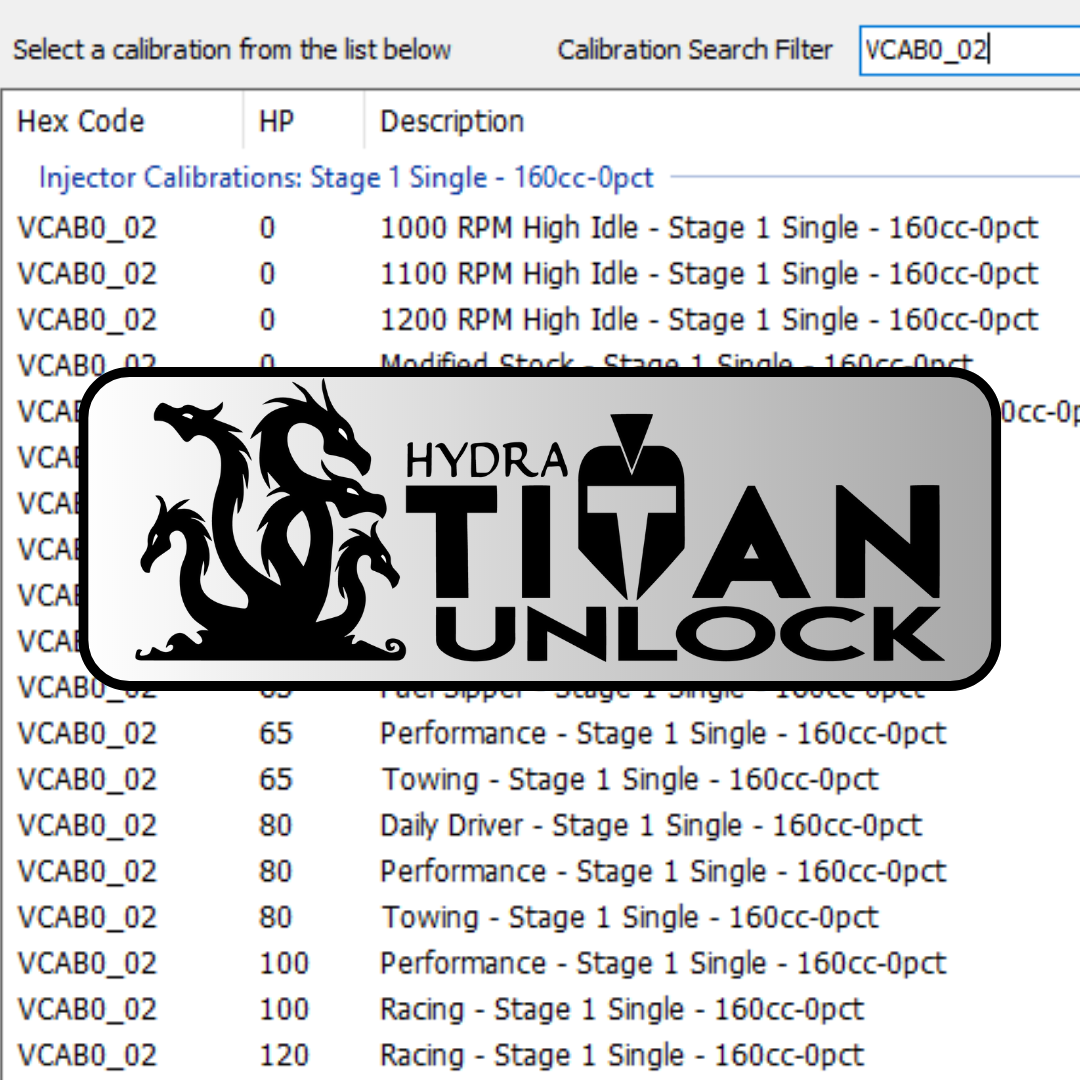

I'm just using the tunes that came with the Fast Force Diesel stage 1 injectors. Not really sure where to go from there. It's seems to idle a bit high 700 and slightly rich for their base tune. P.S. I'm not running hot dog tunes, just base plus, a light tow, and fuel efficiency are loaded.
We will know more once it's broken in.

Okay, it's a PHP Hydro chip, right? If so do you have access to the PHP tune library?
@DEEZUZ really likes his TW tunes. He could give you an idea where to go from here.
Sep 9, 2015
3,602
165
Mesa, AZ
Personally, I really like jelibuilt tunes.

TY for that link. That's awesome! I will budget for this soon.
