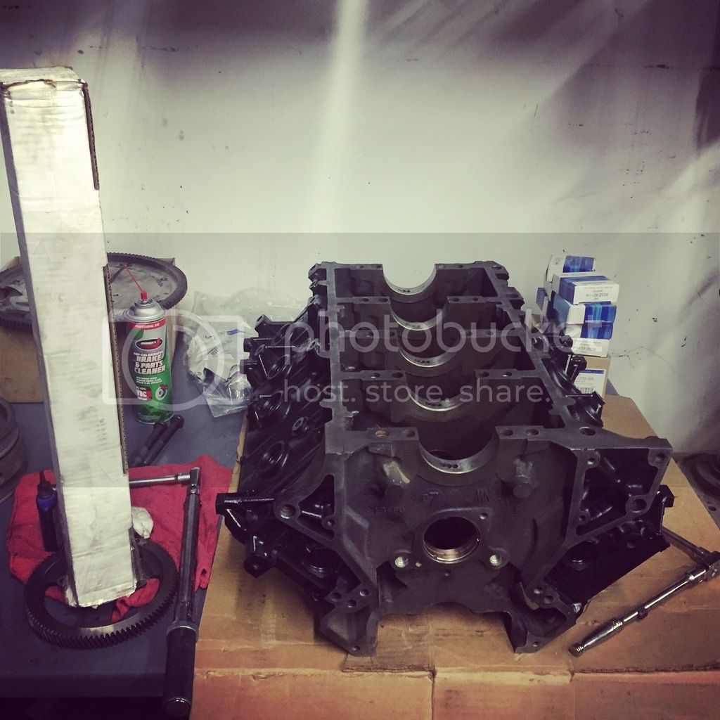

so a little update on this. finally found what i believe is a good used block. should have it up to the machine shop by the end of the week and maybe get a little progress going on round 2

well should have the block in my hands later today. it will be at the machine shop tomorrow. Tyler and Sean from Street diesel Performance are working on getting my other two pistons ready. this used block is going .10 over and going to skip the fill on this one.
happy to finally get some progress on this truck again. April is right around the corner!.

I don't really think you need the fill. Save some money. Hopefully it works better this time!

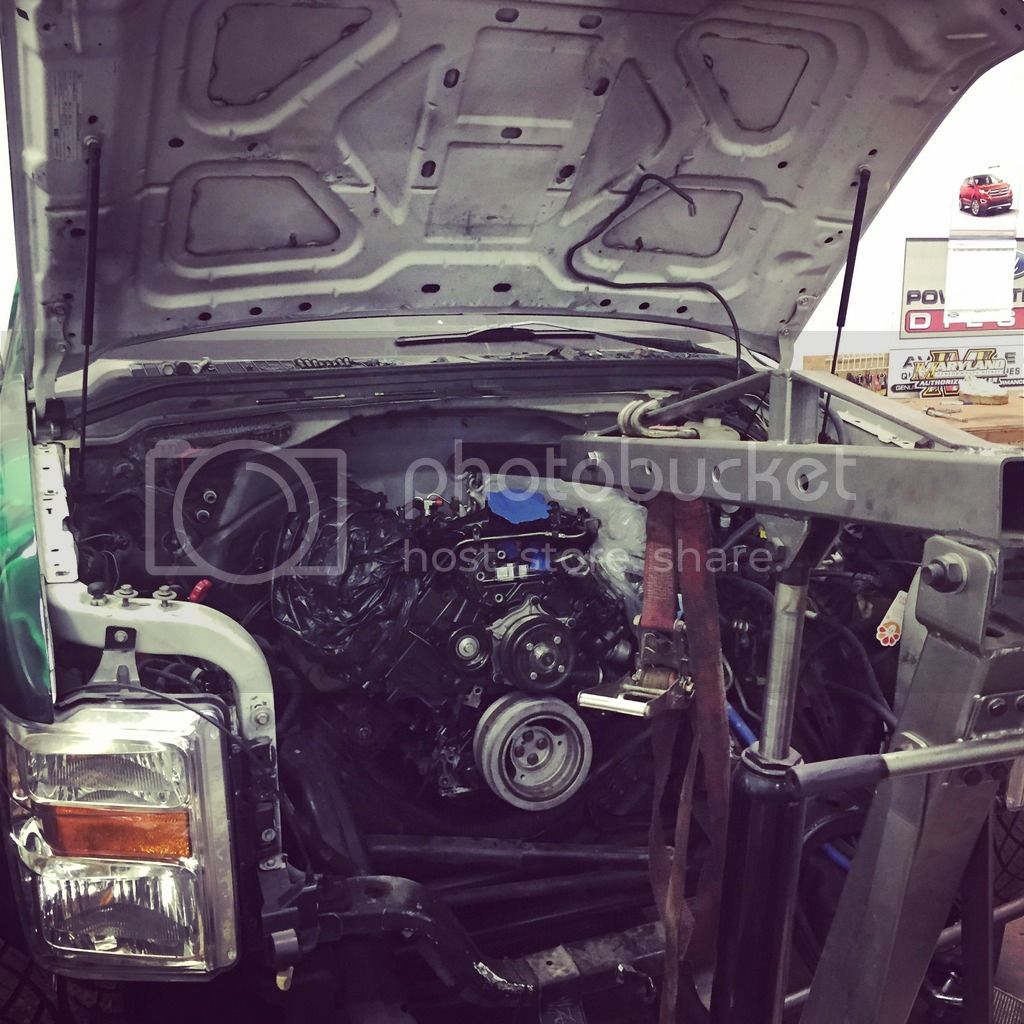

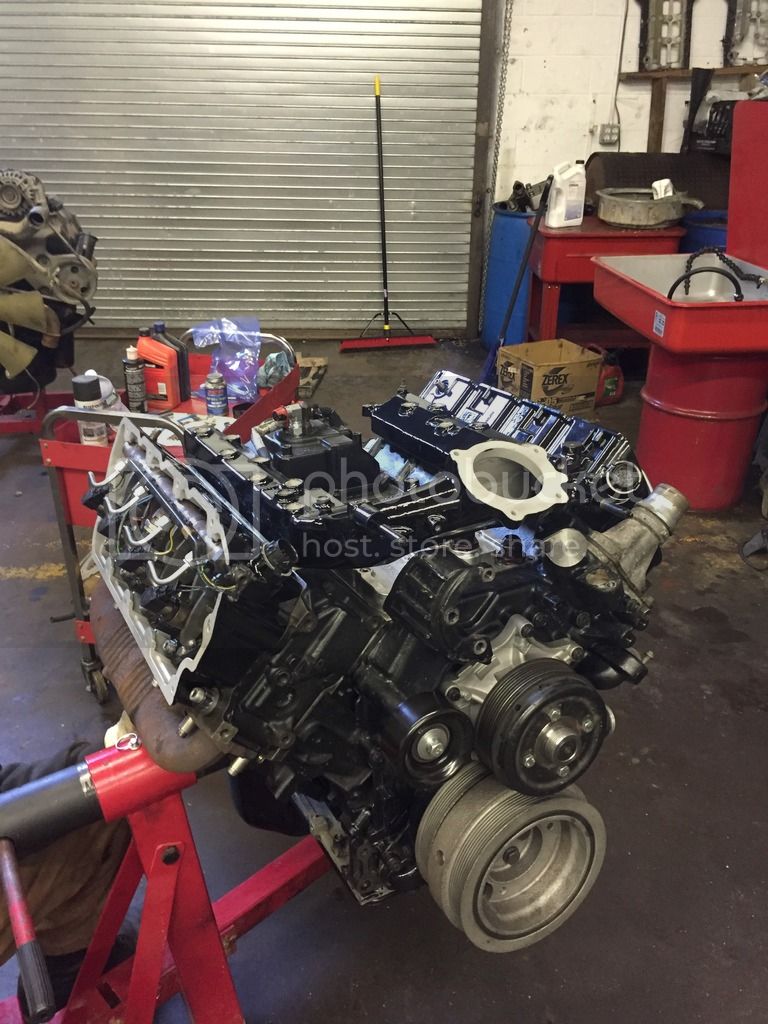

finally on the long road back to getting this truck up and running! we have a few changes comming this go around and hopefully we can keep this one together a little longer to get it dialed in and start making some power!
