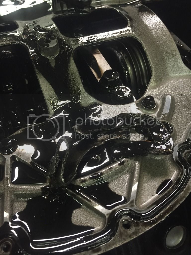

Well il get some pictures up tomorrow but decided to pull the lifters before i started putting the heads back on....sure glad I did. Ended up finding bearing material. Decided time was better spent pulling the motor. pulled the pan and found a thrust bearing laying on top of the upper pan.

holy ballz.. that sucks. but glad you found it now and not after the heads went on and you tried to start it..

That's the second or third motor I've read on this site that has chucked the thrust bearing within the last year. Seems like it was not so common before.
Let us know if you find any more carnage that points to reason why.
