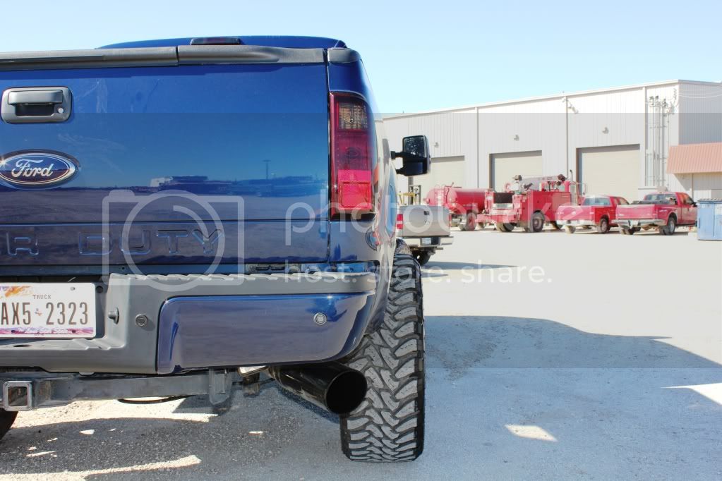

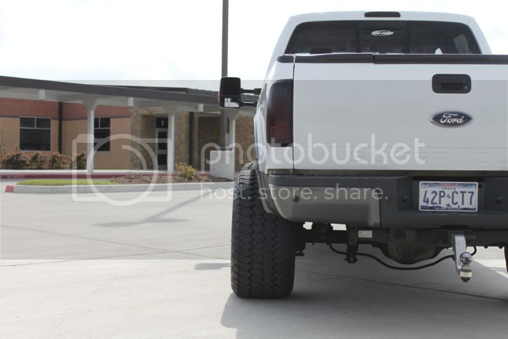

They shouldnt, im running 35x12.5s on a 2.5" level with 22x11 wheels. Just had to trim and pull for them to clear. It would be a nice setup on your truck.
Thanks, Ive got a crazy idea in my head. Whats the offset on your wheels?
I dont want to go higher then the 1inch lift I have in front and I want to stay with 35s.

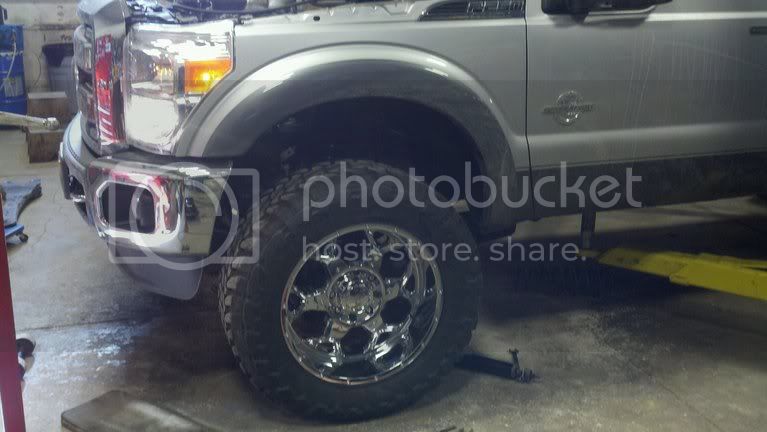

Here is the best picture he has from the front Shone. Truck is in the shop with cab off right now.
He also has a set of 305/45/22 nitto 420s 50% tread $400.
Thanks for the picture buddy.

Backspacing 4.75 Offset -25

Shone. I know fenders are cut a bit different but I barely skated by @ 4.5" and 35's with same wheel because of the offset. With the TEI @ 5.5 I'm good but wouldn't have been comfortable leaving the 4.5.
