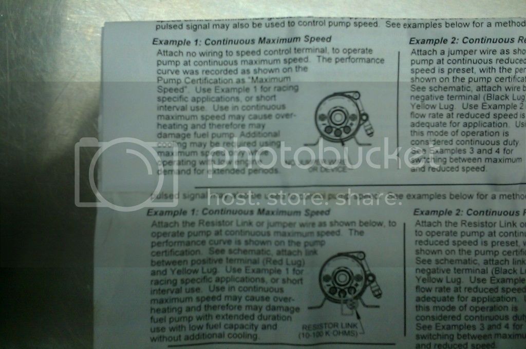

Pump #3 is going a bit nuts on me. The video show what its doing, but for those without experience with these pumps the center lug is the speed control. When this lug is left alone the pump should be at full speed, ground it out and it runs at reduced speed (according to the latest diagram..lol). In the video the top lug is ground.
