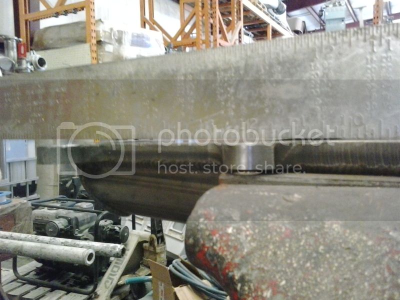

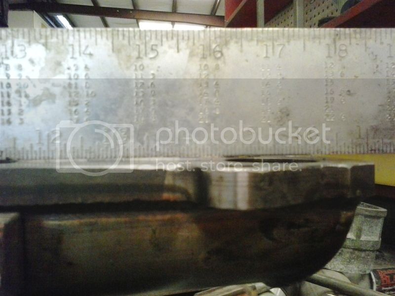

Well I pulled the driver side manifold off and the bolts were loose again and when I threw the straight edge on it the damn thing is shaped like a U so I will be putting the stock manifolds back on. Does anyone want a set of RCD stainless manifolds?:doh:

I know it's not the best straight edge but you should get the point.
