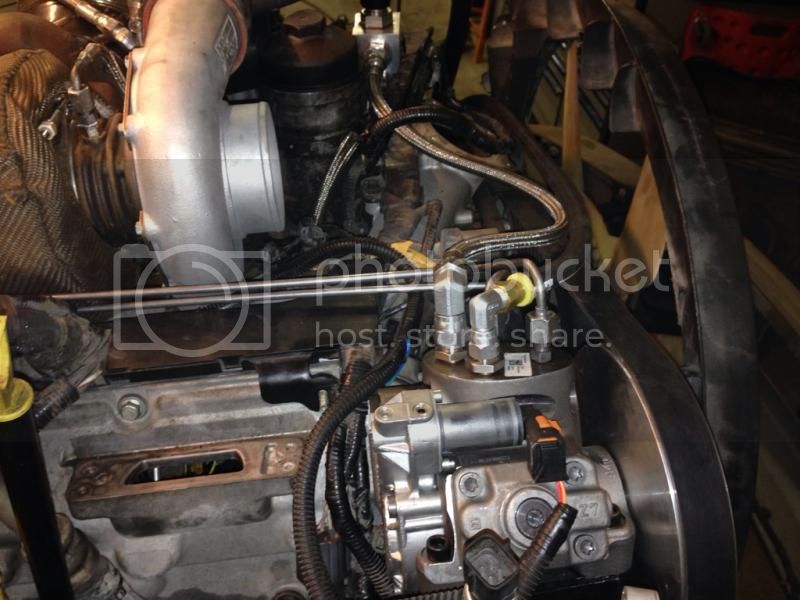

What is the best way to bleed the fuel system after installing dual pumps and a new low pressure system? I just don't want to send any dirty fuel into all this new stuff.
White_monster
3,177
The great white north
When I did it I ran my returns into a bucket and ran the low pressure pump till fuel flowed out without air. Other than that you can't do anything on the high pressure side.

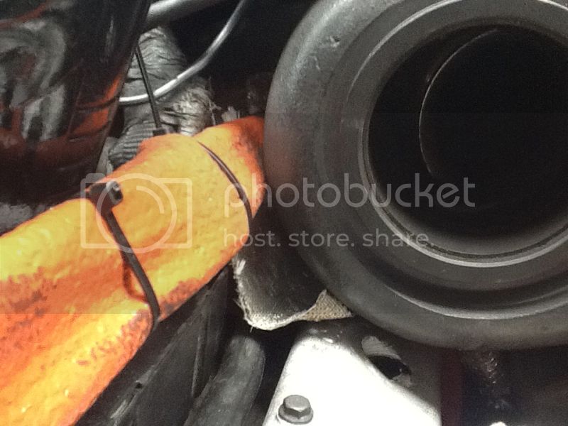

Ran into an issue with my dual fueler. The exhaust housing is too close to the fuel lines. Right now it is barely touching and I have some fire sleeve between it and the housing. Any ideas? The lines are pulled over as far as I can get them.

After looking another Midwest setup with Max Powers I guess that is just how it is. Hopefully between the fire sleeve and a turbo blanket I will be good.
From another build.
Jonnydime
Jun 26, 2012
2,319
8
Whs^ Morgan did my build. Mine are close but not touching. No issues.
They are bent over as far as they can go. The engine harness is there as well as the plastic coolant line. If I take the fire sleeve off the lines are not touching and with the fire sleeve on it barely touches.
Jonnydime
Jun 26, 2012
2,319
8
That's what I'm thinking. I plan to get a turbo blanket as well so that should help.

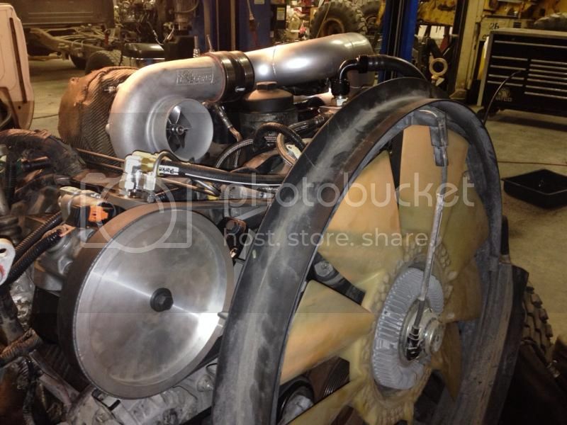

Jonnydime
Jun 26, 2012
2,319
8
IT RUNS!!!! Bad news is I somehow broke the plastic coolant line that goes to the passenger side valve cover:(:cursing:. So it looks like the low pressure turbo is coming back out.
Riverside
Nov 10, 2013
410
southern Oregon
I hate that line with a passion !
Congrats on getting it running.
Look forward to seeing how it does
Jonnydime
Jun 26, 2012
2,319
8
Yeah I hate it too. It broke right where it bolts to the motor. I thought I might have heard it crack when I was reinstalling it and said to my self "I hope that line didn't just crack". I'll pick up a new one tomorrow:lame:. I still need to run the water lines for the turbos anyway.
