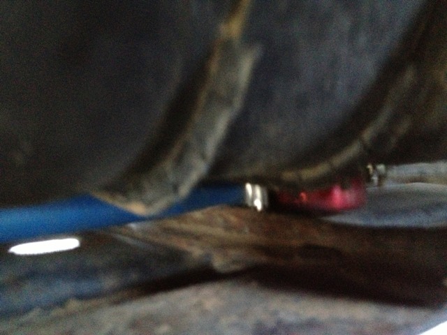

I've been running my Hellman sump with no skid plate for over a year. I noticed a nice ding in the sump from a rock or something, I'll be looking to modify my skid plate to put it back on soon.

This is how mine is with a hole cut in the skid plate.

cut a hole in the skid plate with a hold saw, i was going to, but I never seen anything but the road.
So do you have a skid plate laying around? I want a sump, but can't find a plate and I'm not about to drive through pasture without protection, and I'm not paying Ford for one.

I used a Truck Source Diesel sump..no worries with mine. I had the skid modded to fit lower using some welded on blocks. Fits great and protects the sump and line. I will say I haven't read of anyone without a skid hitting road debris.
Heavy, do you have any pics?
