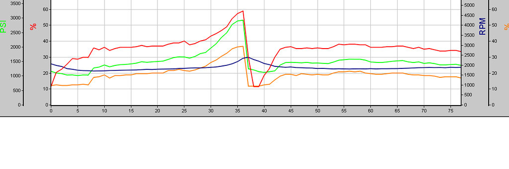

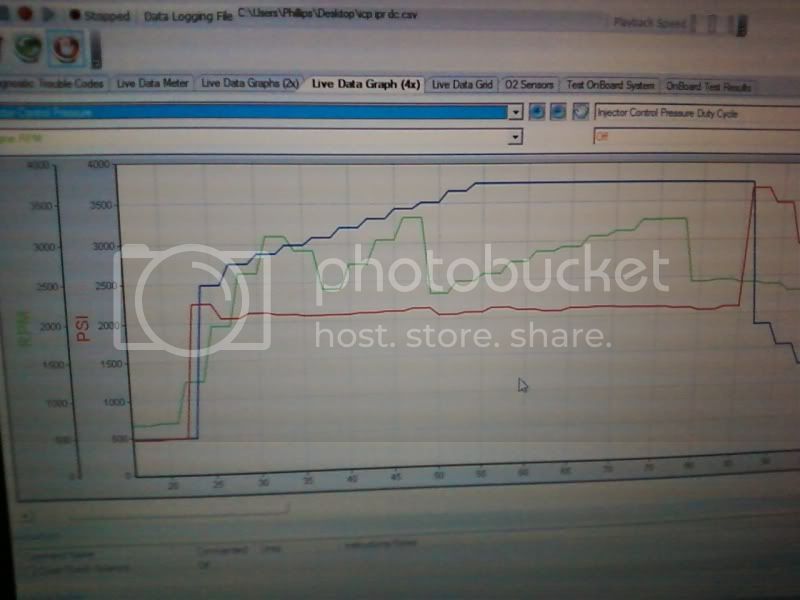

My HPOP is junk. I have stock injectors, and at WOT it holds 2100 PSI at 92% IPR DC. I think the junk HPOP is causing some of my other issues as well, such as poor fuel economy, and some odd driveability issues. With that said i am going to buy a new one. I just haven't decided what route i want to go yet. I will be getting better than a stock pump, since i plan on doing injectors soon. I don't know what size injectors i wanna get yet, but i have an idea. Basically i wanna know what HPO systems will handle up to about a 300cc hybrid while still maintaining a decent IPR DC with full pressure. I don't know if i'll be going that big on injectors, but just in case some day i do, i wanna have it covered. Just lookin for some ideas on the limits of different HPO options.
