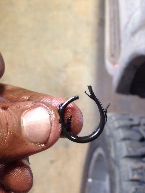

Ugh...dead again lol. Died going down the highway and won't build icp at all. Thought I blew a nipple ring so I tore it apart and used starter wire and no oil squirted out. Dummy plug gaskets good. Pulled stand pipe and it didn't seat right. Fixed that and I'll build icp slowly but not 500. So now going after ipr...probably broke an injector tab off and it got sucked through....

You sure all the nipples on the oil rail aren't pitted or the orings aren't bad?

Yeah I checked nipples, they are perfect. Checked o rings in injectors and no Knicks or cracks. Pulled ipr tonight and screen was perfectly in tact. Also when I pulled the valve cover if I had a bad seal. When I jumped the started wire shouldn't I have seen oil squirting out. Cause I didn't?

Yeah I know this on the air test. Just no way to air test unfortunately. So I figured it was with something I did in the injectors replacement or contaminant and sucked through ipr...and I do have early 04 oil rails

Found the culprit! O ring from the hpop to the discharge line. I probably over torqued it. 8 lbs comes real quick!
