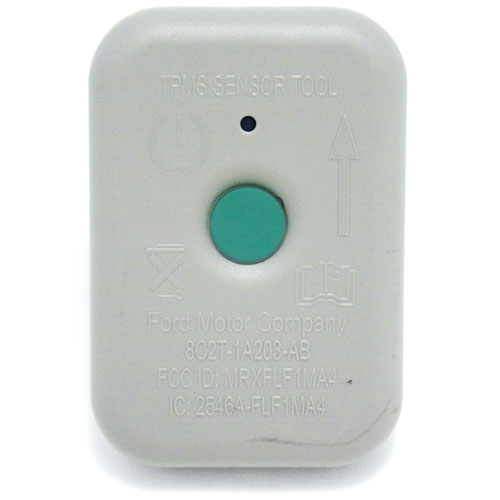

I just bought a 2008 f250 6.4 with aftermarket rims and I have this damn tpms light on has anyone else figured out how to shut it off? Any help would be great. Just installed dpf delete and sct tuner.

with a special tool coupled with an H&S tuner.

What the play here for a Spartan tuned truck?
-Find MiniMaxx (Does it matter if its Dodge or Ford?)
-De tune the spartan tune or can I just plug in the MM?
-Plug in MM and then do what with the Tool?
-Is this tool just the little FOB with the green button? If so I have one that I could lend out in BC Canada...
Sorry about the brain dead post but Ive been looking at this damn light too long, making me go stupid!

Someone else will have to confirm the Spartan side for you but I believe you have it right.
For the little FOB w/ green button, that is the activator fob, you will need that to program the sensors but the thread is discussing the H&S TPMS tool, this is required along with the H&S MiniMaxx to get the trucks values programmed, then after you set that, you use your little grey/green button fob to set the sensor ID's with the trucks system, hopefully I haven't confused you :)
Your tool (not required but makes life super easy);
H&S TPMS OBD2 dongle (required);
