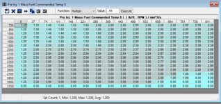

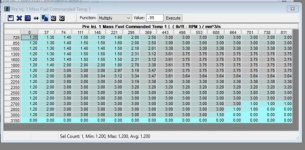

depending what BASE file the tune was built off, HS for some reason pulled some Pre injection 1 fuel amount from the table in some of the tunes... thats the one that will casuse you to hear that sound.... they puled it right around the 2000RPM mark in the upper load range. ensure that your activation maps are on ( set to 1) for the pre injection 1 maps, ( dont worry so much about pre injection 2 activation tables in the upper RPM) then go over in to Pre inj. 1 mass fuel commanded Temp 0, and temp 1 and ensure that there is not 0s in the area of the rattle ( likely if your getting a rattle there will be no commanded mass fuel amounts) ... if there is 0s start adding fuel till it shuts the rattle up and makes a happy sound ( if you have access to the tune thats in to the truck, im assuming that its got custom tunes if your running a single with bigger sticks) .

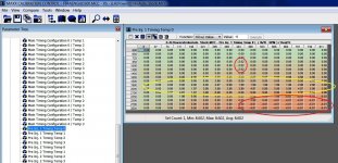

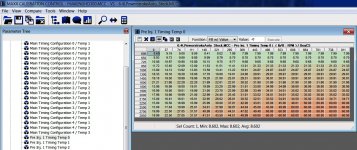

They also changed the timing (BTDC) in both pre injection 1 & 2 tables. Mostly increases but also some decreases in timing.

That timing map looks odd for a pilot timing map. Should be way more advanced than that. Stock is 15-30 degrees most of the time

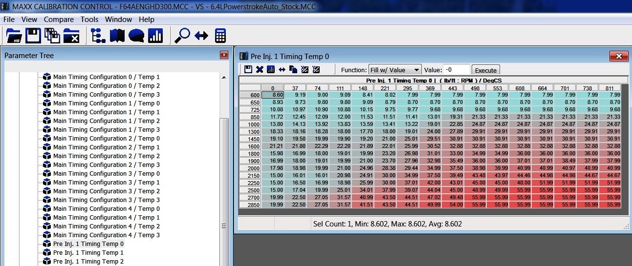

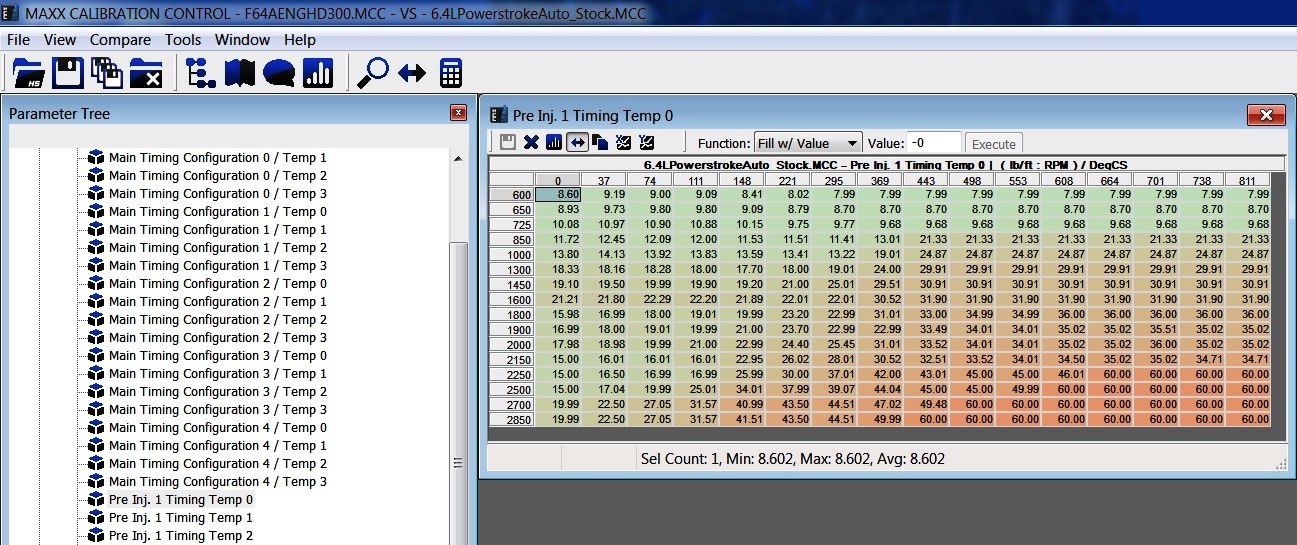

Sorry, that's using the compare difference function between the H&S 300 map & the stock Map.
these are the actually maps

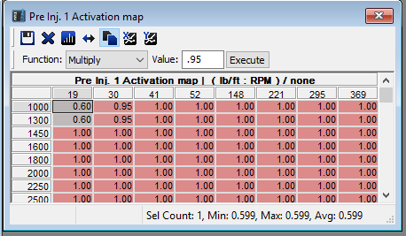

never mind, got it figured. Curious is the lower fuel mass in the lower rpm and torque range will give the rattle sound and if adding more fuel might help clear it up. Also where does post injection come into play and why is it mostly off. Post injection used for *** regen ?

Kind
1,498
Yes, post injection is primarily used for emissions.
On other platforms people have used it to help spool chargers but we are unable to do that.... I tried lol.
