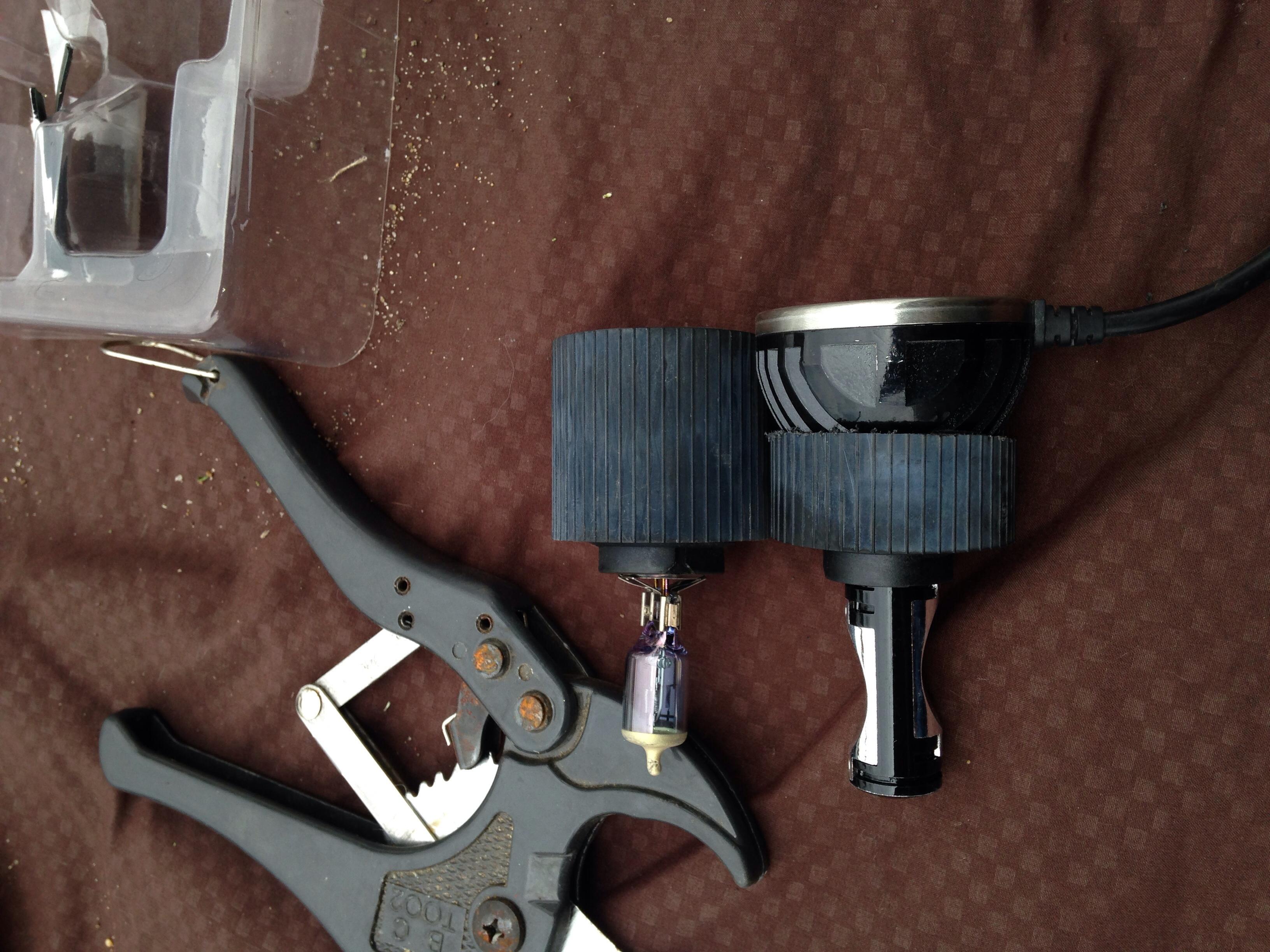

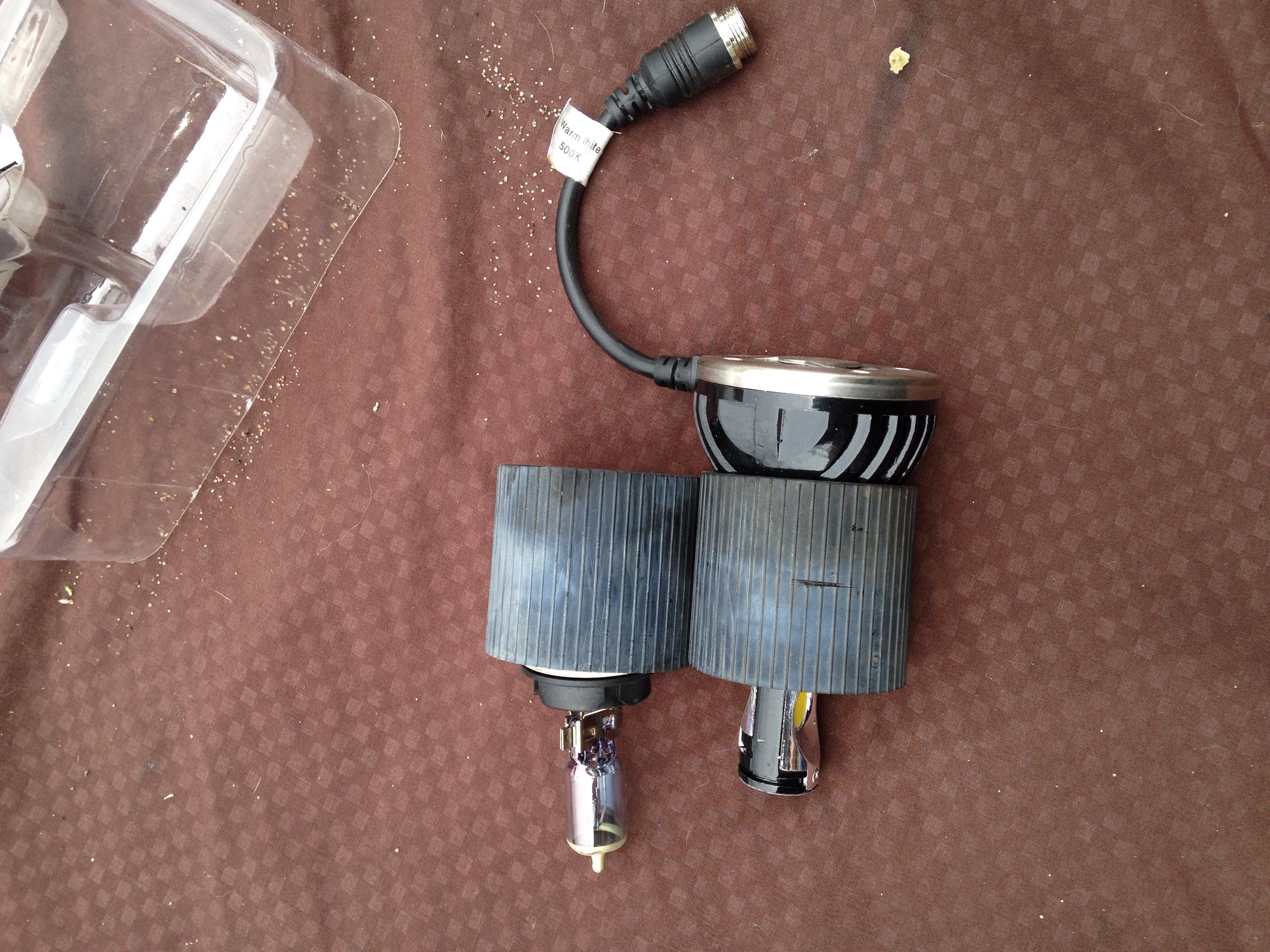

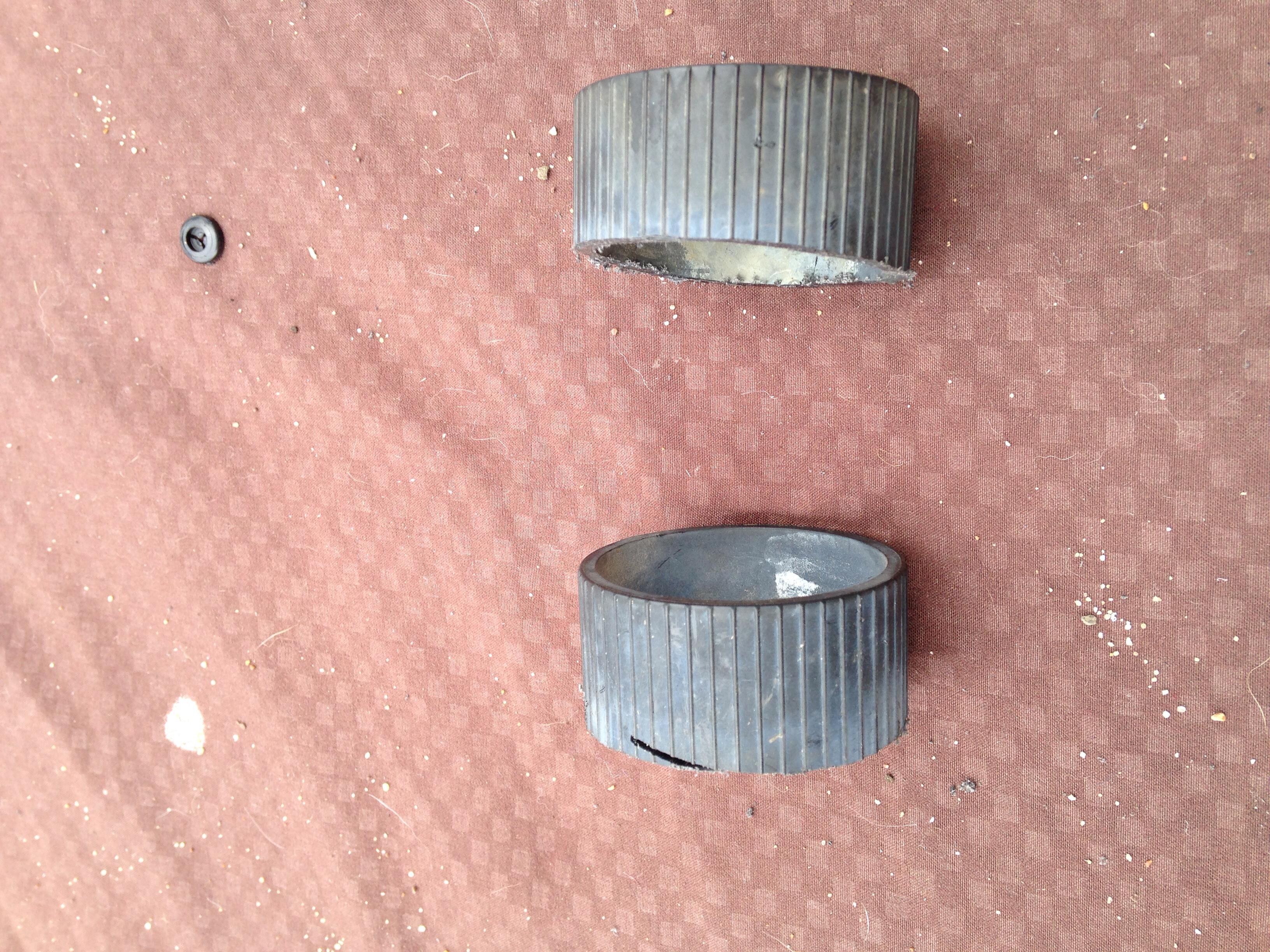

So with a 9007 setup the factory lock ring is what holds the bulb in normally to adapt to these you need to cut the factory collar in half so all that's left are the retaining tabs and lock cams if that is understandable. The oracle collar goes into the headlight housing and then the modified ford collar over that which then does the 1/4 turn twist lock now the oracle collar is locked securely in place
Then the bulb itself inserts through the new "assembly" and also does a 1/4 turn to lock in

Pic

I had to cut my factory lock ring down to 3/4" thick. Keep that in mind when selling to an obs guy. Also noticed the position of the bulbs tabs puts the low beam on tip and high Beam on the bottom but I feel it should be the other way around
