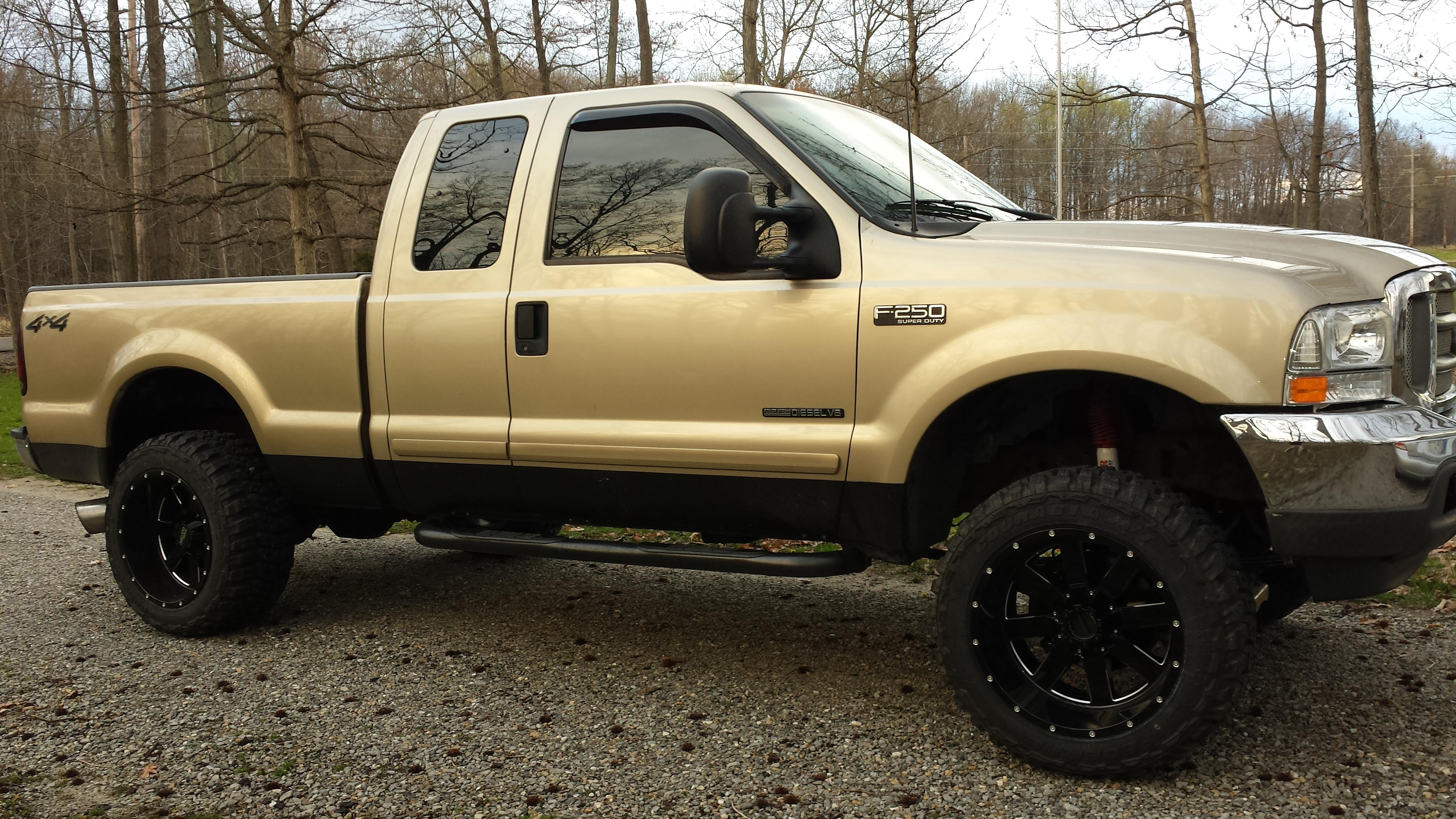

I have Pro comp 2" leveling springs in the front of my truck w/ a drop bracket for track bar. 20x12, -44 offset w/ 33x12.50's. Mine sits level but that is my truck. I don't have any blocks in the back either, my springs sit right on my axle.

Here you go.
