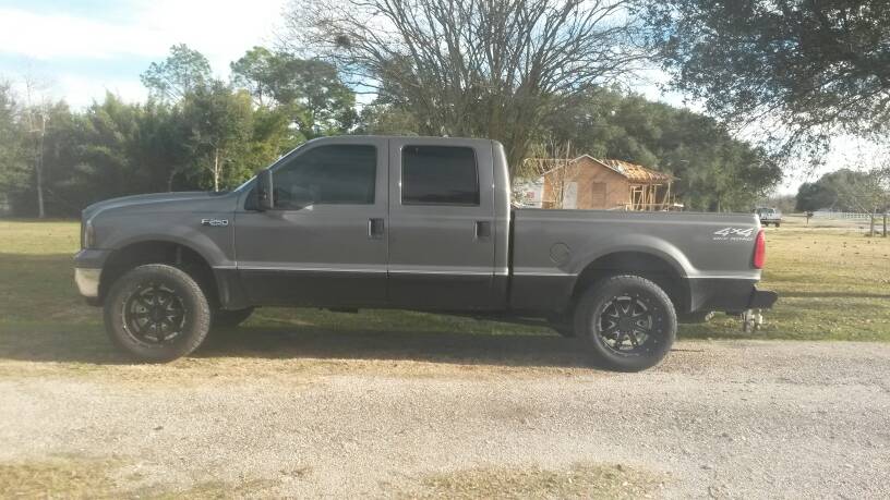

Here you go.
X codes and stock 250 block out back
Tires are 305/55/20

Get em swapped out yet, any pics?thanks man
