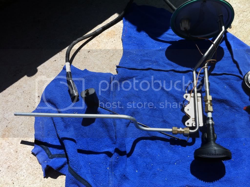

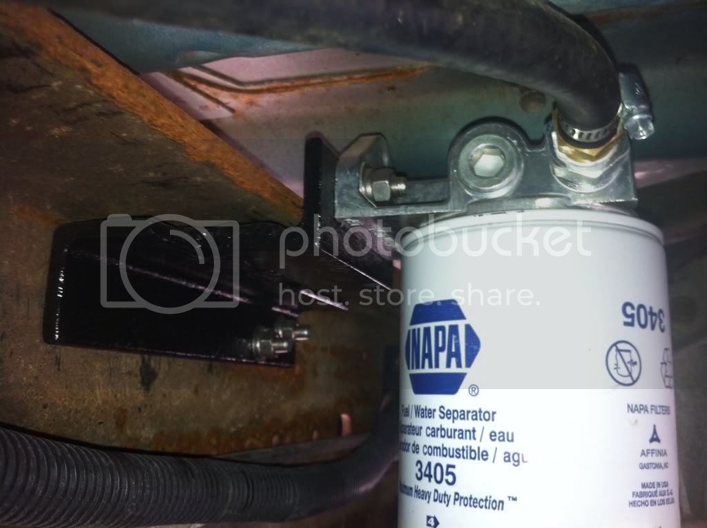

op, your filter is fine... i think that is the cross reference to the baldwin bf1212 that most sell with there pre pump kits. i ran the frx for a couple years until this past summer when i thought i had some problems... i changed my pump out with a new one, didnt help, took the frx out of the equation, didnt help.... added a pre pump filter and a carter high flow low pressure pump, 5/8 pickup tube and 1/2 inch lines from tank to pump, didnt help, bought a aeromotive regulator to bypass the stock fuel pressure regulator, and WALA!! holds rock solid at 65 psi with no drop what so ever.. i took the frx apart and ran those liines to the aero regulator, plugged one hole on the frx block and drilled it out so it would flow better and ran the return from the bottom of the aero reg to the frx for the return line and blocked off the stock fuel pressure reg....
since that was the fix i tore into the stock fuel regulator to see what the deal was, turns out that there are more o rings inside it then what i knew about... and sure as chit one of the internal o rings where tore... i would check that first, and check it closely because the slightest little tare will hinder it... they sell rebuild kits for it... im not saying that is the problem but try that as thats the cheapest fix first and proly after that you can replace your pump.. riffraff diesel has the cheapest price for the stock bosch pump at 145$ so i would do that after i checked the fpr o rings... i am not sure if riffraff or any other vendor sells that rebuild kit or not but i am sure dieselorings.com does.
