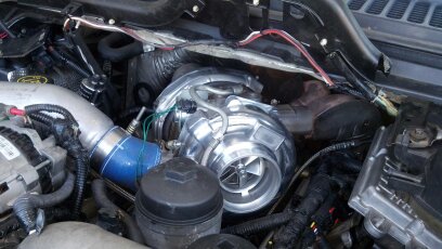

This sounds like a very cool build. I have been wanting to try the diesel site HPOP and delivery system but can't justify it just yet. I am curious to to see what you find out.
One recommendation for you, and this is just my opinion, would be to ditch the factory limited slip and get something like a detroit tru-trac or a full locker. If you plan to make use of all the power you plan on making, the factory limited slip probably won't last long. It only took a couple of burnouts and one boosted launch for my truck, which is only in the low 500s for hp, to do a number on the factory differential.
I am looking forward to seeing how far you can take 175/75s.
