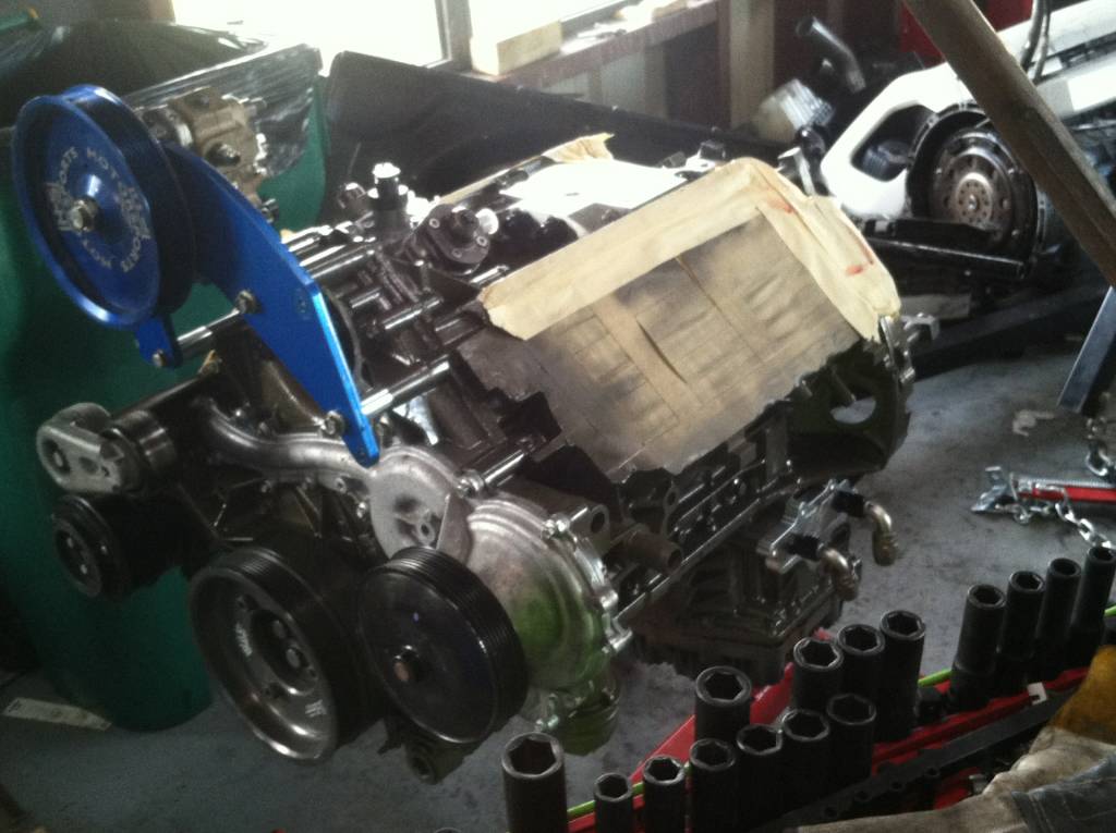

I figured I would start a thread on my build.

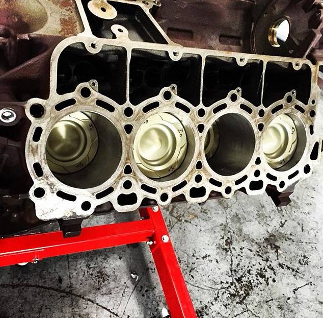

I first built a 61 VGT / 75 atmo compound setup and made 605hp. I've now stripped the motor and have decided to do a full build. Also bore the block .020 over.
I should start receiving parts next week. So far I've ordered the following.

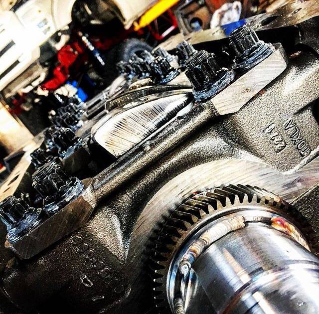

Pte 68/70 gen2
Arp main studs
Chromoly pushrods
Valve springs
Stage 2 cam
R&r rods
Billet aluminum Pistons
Zero gap rings
H13 wrist pins
New OEM valves
New OEM gaskets and bearings

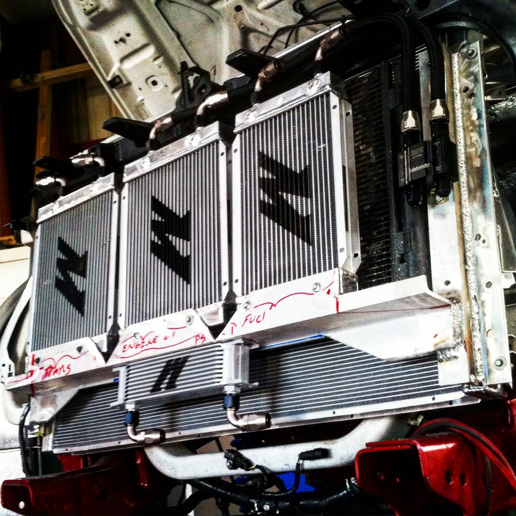

More to come:
Pte pro mod 102
Aeromotive fuel pumps
Big water to air intercooler
100 percent over injectors
Lots and lots of nitrous
Some trans parts
Some small secret things
...... Deleting the glow plugs.
