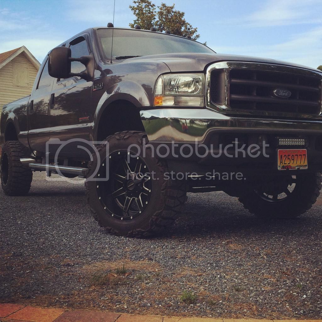

Im new to the forum here. (Been here awhile but never introduced myself) but id just want to give you a small update on how my new truck is coming along. Back in december i bought an 04 ccsb lariat with 117k on the clock that has all the bells and whistles except the sunroof. Im a current college kid at nc state so this build is gonna be pretty slow and on a college kid budget. I didn't buy the truck so much for what it was but more of what it had. It had already been studded, bulletproof egr and oil cooler, 4.5 bds lift, wheels and tires, edge tuner and a set of strobe lights and a 4" exhaust and down pipe and a aem CAI. It does have some rust being a jersey truck but the price was way to good to pass up.
So far on my personal list of upgrades is
Sct x3 with innovative tuning dynoed at 366 hp/666tq with extreme X on the 17s
Blue Spring update
RCD Egr delete (installing this week)
Small 10 inch Cree led light bar
20X12 Fuel Mavericks with 35inch mud grapplers
and led lights everywhere! ill post pictures later
So far I'm in love with this truck and I'm far from done but soon my plans are either a stage 3 (or 4) from barder or a s366 66/74/.91 with divided uppipes (I'm worried about the spool up with this set up) and a set of 225/100 along with all the other goods its gonna take to get there. Im no where close to done with this build until I'm at the 650-700hp mark with 35s on 20s.
how it looked when i bought it
how it looks now
look down the side
view from the top
dyno numbers
the led bar

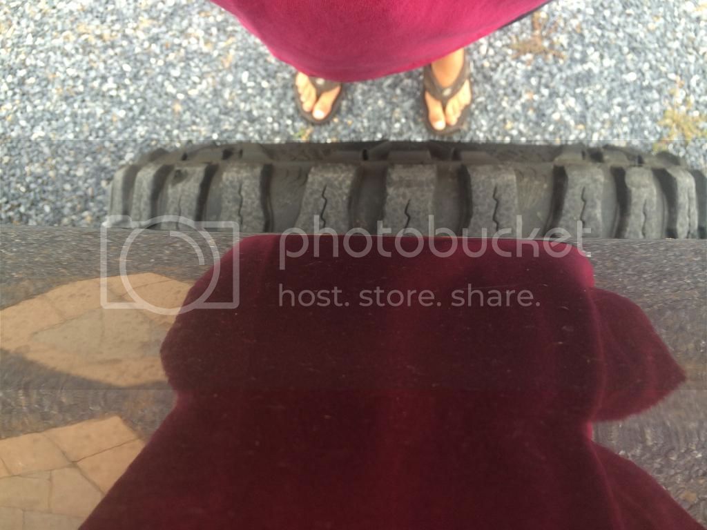

Did you have to do any trimming to clear your tires with the 12" wide wheels on?

Yeah I eventually wanna run a set of 175/75s or maybe even bigger but the end goal is a set of 225s with a s471 mm as a track set up and a s366 or s468 as a street set up.

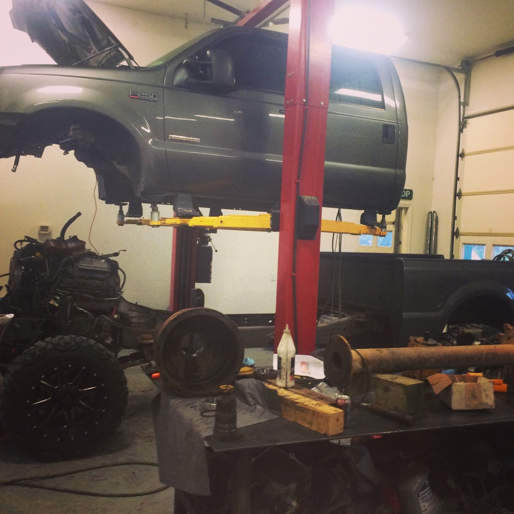

Finally had time to pull the cab off the truck and get the turbo on along with a few others odds and ends. This turbo is awesome I can make 1 pound of boost at 1500rpm and when casually driving boost comes on about 1800rpm. While I had the cab off I did a full egr delete and did a set of prep lines from Marty's diesel which will allow me to do a complete full system later. ImageUploadedByTapatalk1417368908.493481.jpgImageUploadedByTapatalk1417368952.398373.jpg

Finally had time to pull the cab off the truck and get the turbo on along with a few others odds and ends. This turbo is awesome I can make 1 pound of boost at 1500rpm and when casually driving boost comes on about 1800rpm. While I had the cab off I did a full egr delete and did a set of prep lines from Marty's diesel which will allow me to do a complete full system later. View attachment 32667View attachment 32669
Looks awesome man. Marty's definitely had a great idea with that prep kit. Without reading through the rest of the thread..... what injectors are you running with that turbo right now?

Stock right now but will probably go with a set of 205/100s eventually. I'm just gonna go big and have fuel pulled out. The prep kit is nice but I wish I had the money for a full system. I have a boost leak some where but definitely impressed with it
