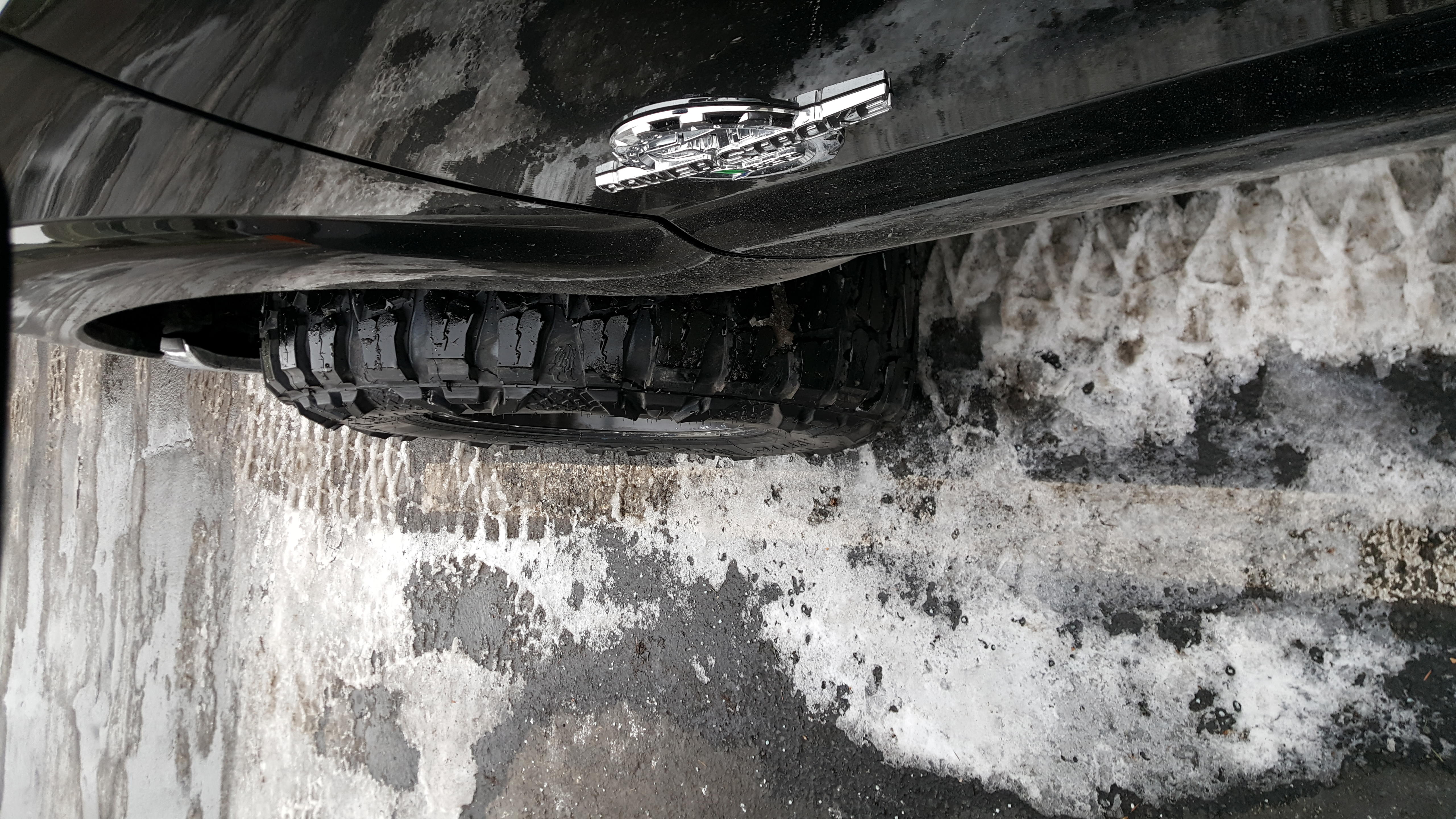

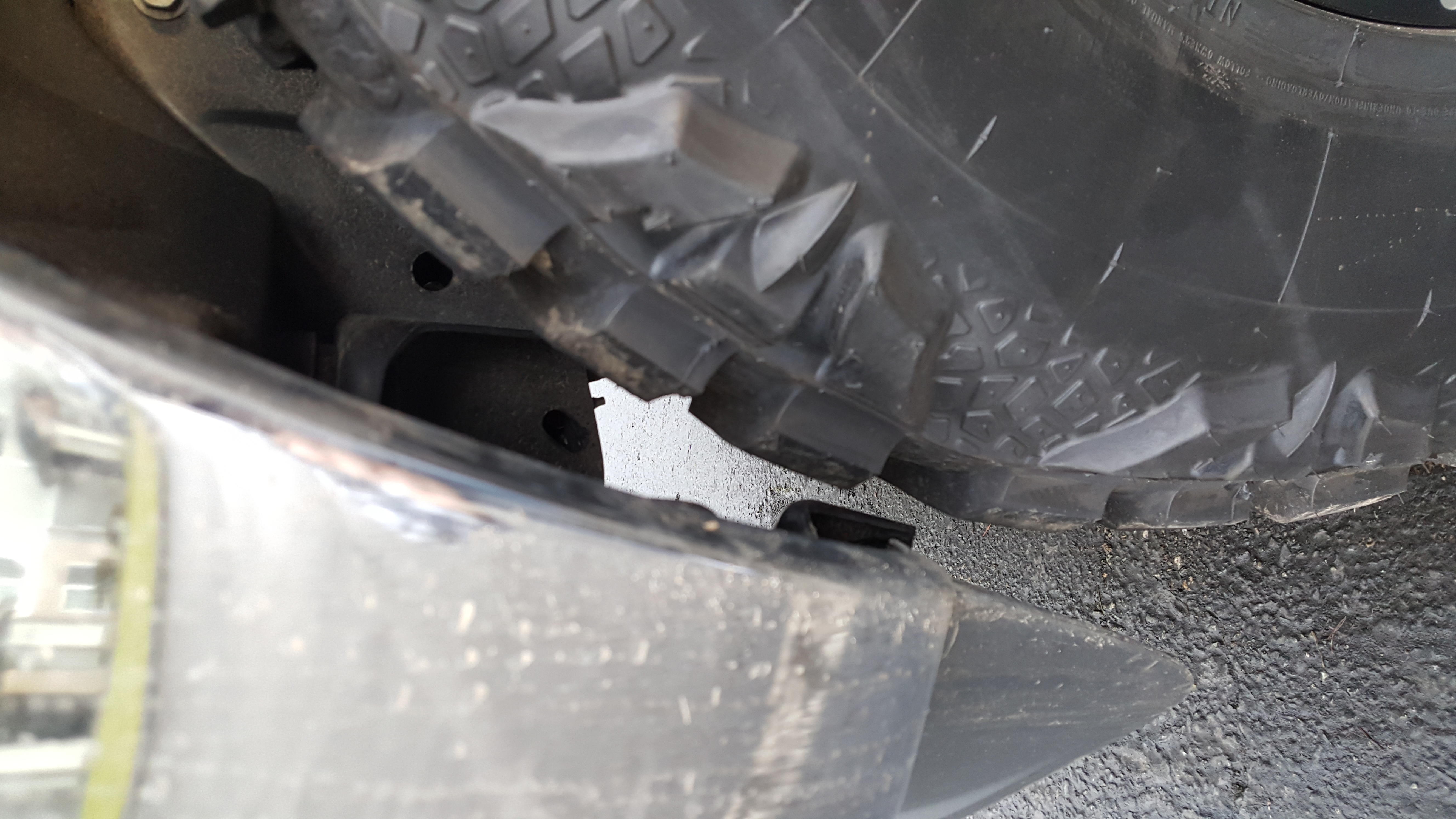

Thanks T_W6.7. I did trim just a tad but my issue seems to be the medal part connected to the bumper. So when you turn the wheel right it rubs against that. I did look into spacers and I think that could be a good option. I read that with 35's a 4 inch lift is good and a 6 inch might be a big much for those size tires. Here is some pics of what I mentioned

I would first try a nice leveling kit. There are plenty of vendors on here that would probably be more than happy to help you out. 4" lift might be ideal, but considerably more expensive, I have a 6" on 37" on 22x12's with a -44 offset so they stick out quite a ways with no rubbing issues at all. Every setup is different, but I think you could probably get a way with a leveling kit.

Welcome! Like already stated a leveling kit would probably be enough to clear. Best I can tell from the pics anyway. Post some pics of the whole truck!

Space the bumper forward with washers.

For people saying lift it. How does that help? On compression, the tire will be in the same area. Unless the OP doesn't plan on flexing at all.

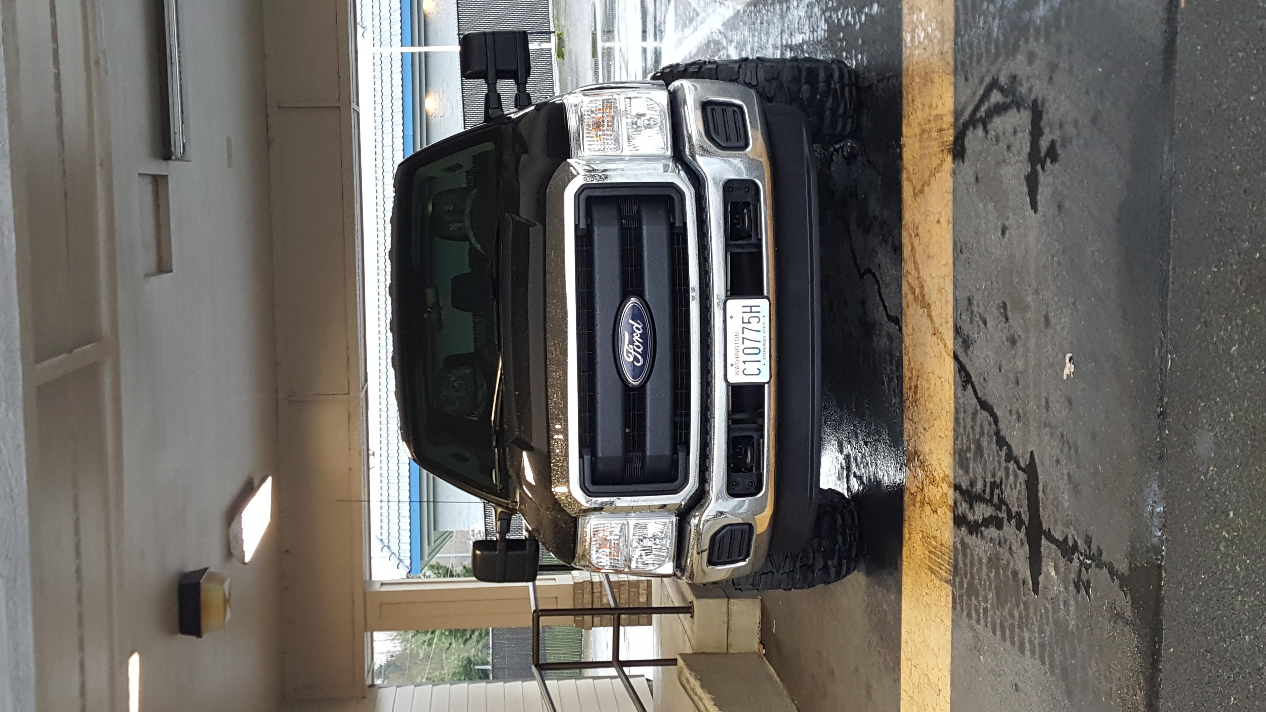

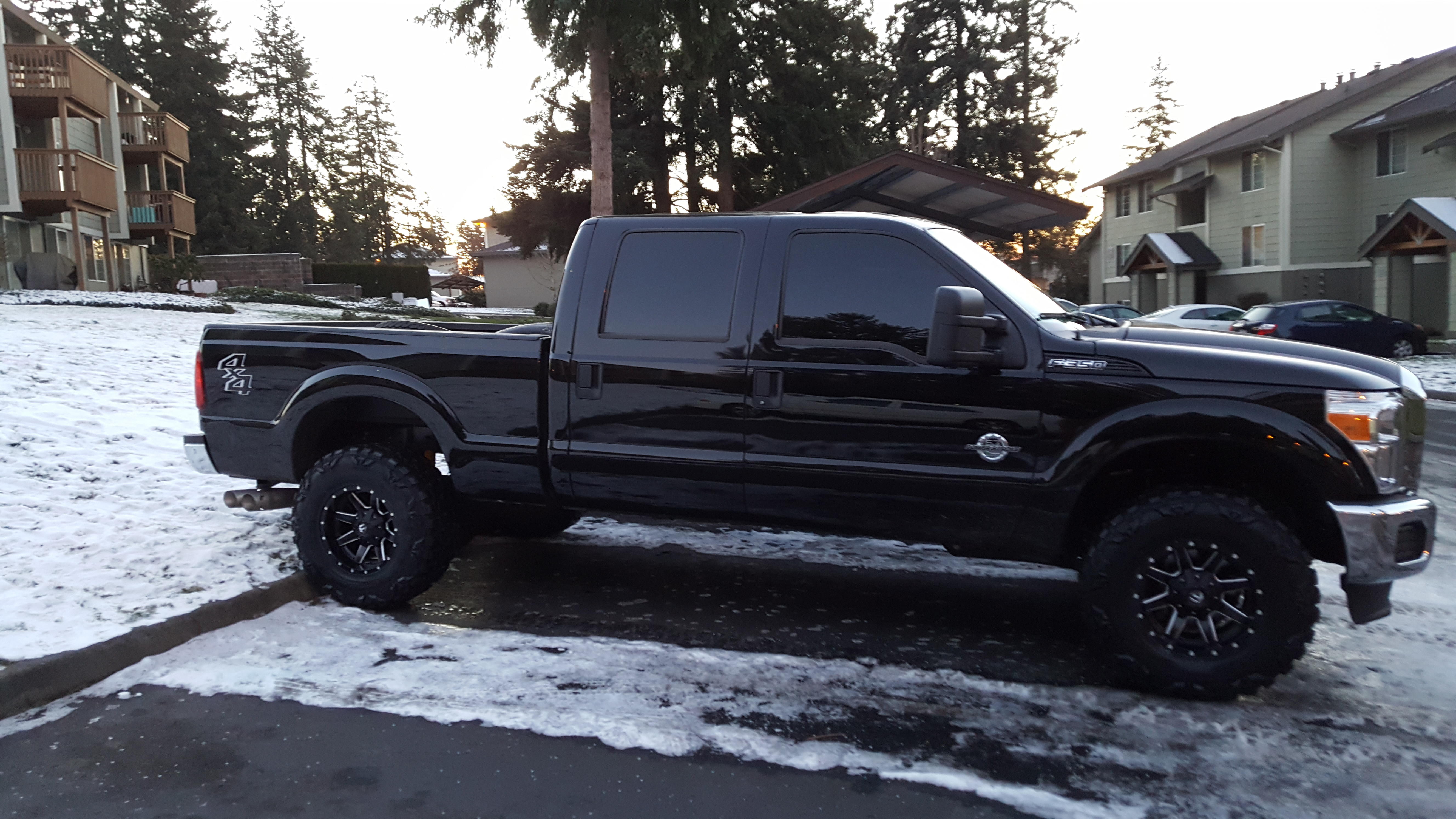

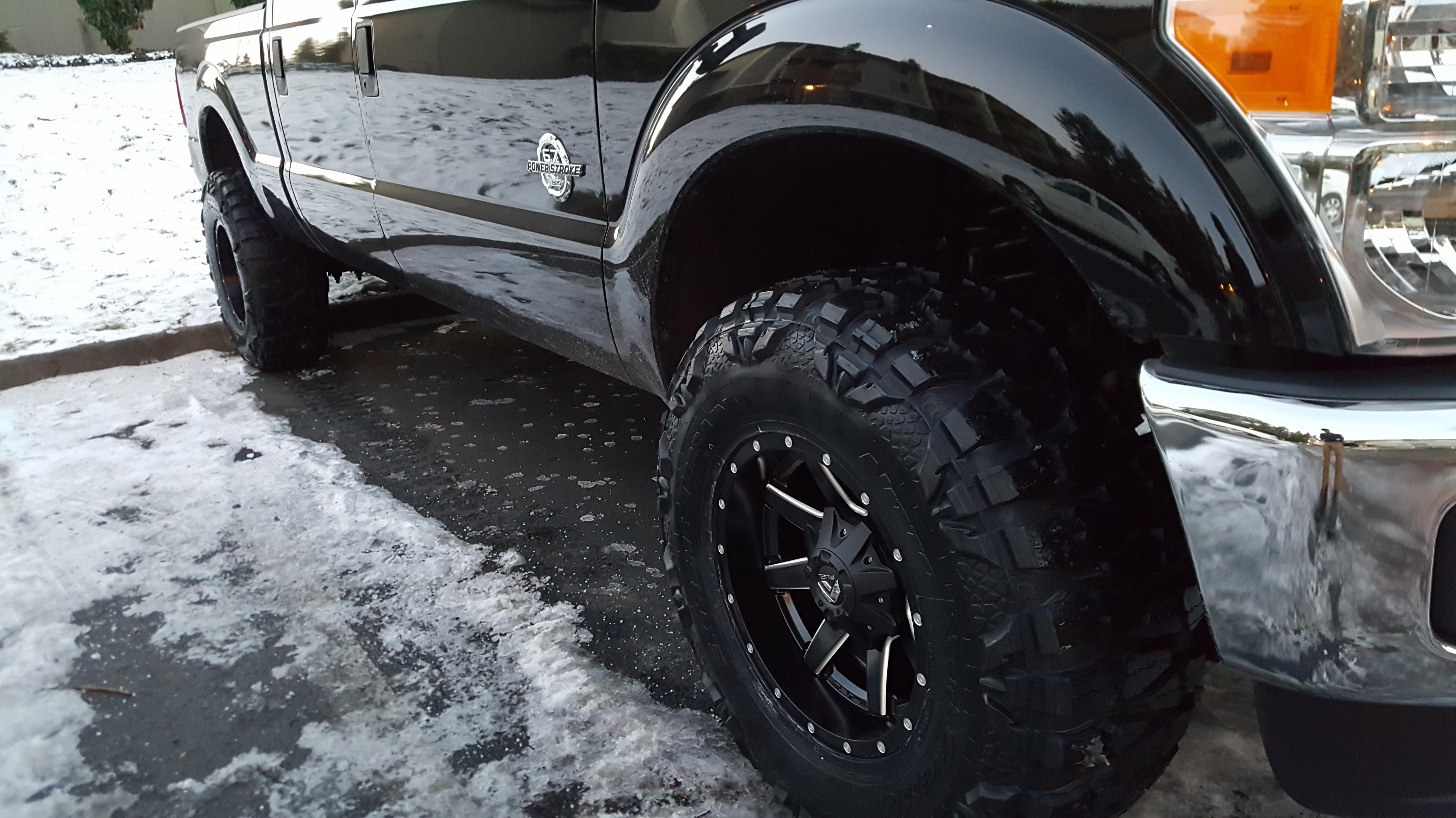

Thanks 01pwrstkr
