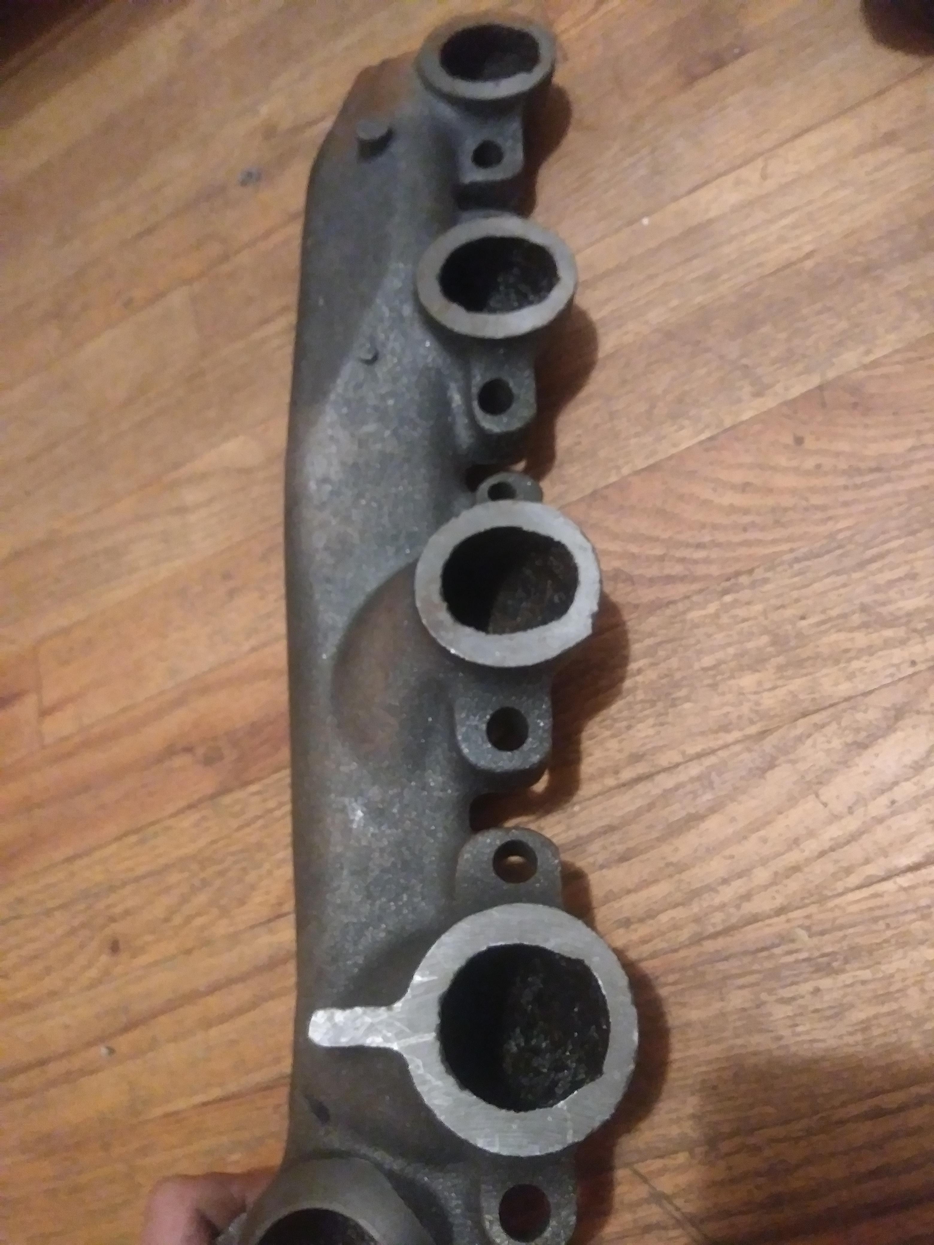

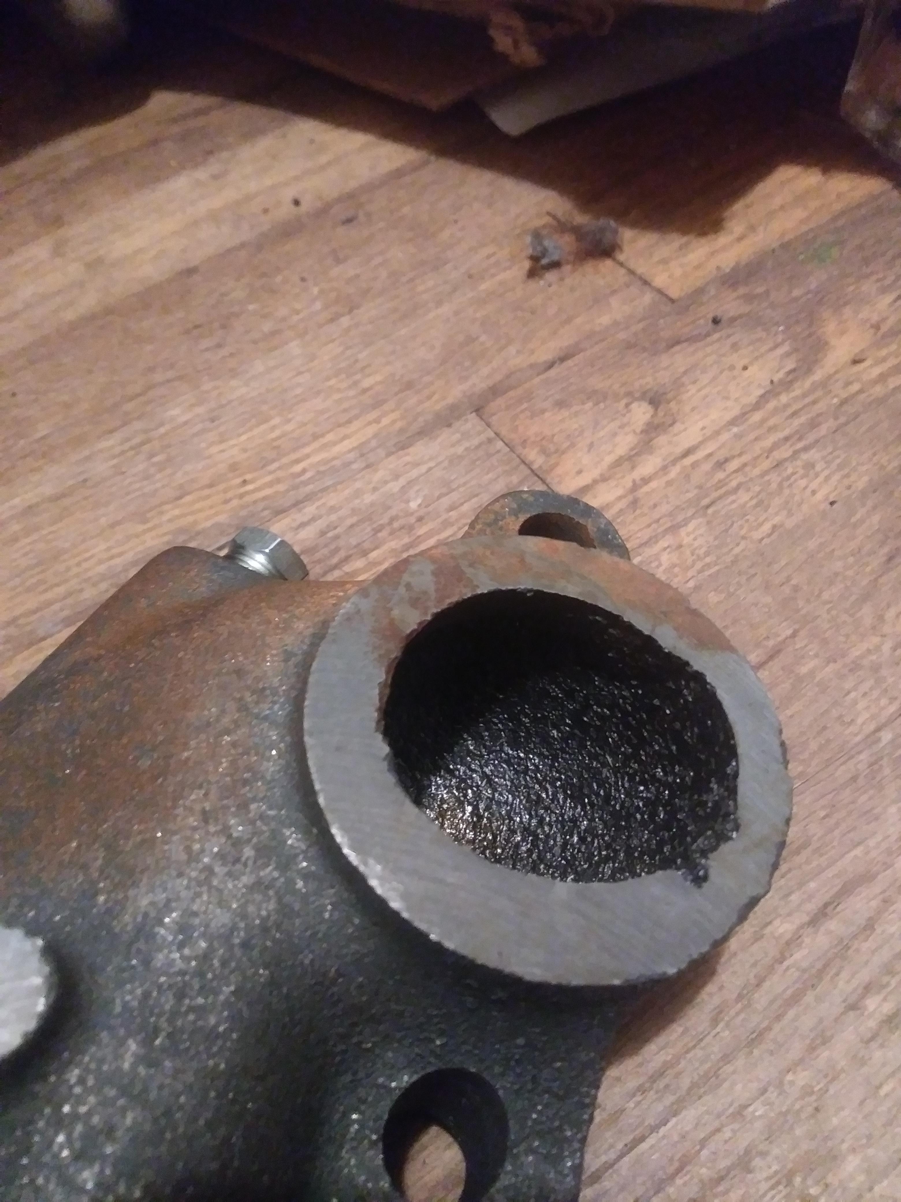

Hey all. I got some new Doorman exhaust manifolds.. I figured how bad could they be.. but I do know better.
the casting is really rough and grainy. if you stick your fingers in the ports you can chip off some of the iron. the passengers side is even worse and the port holes aren't even completely round.

I don't think I'll have an issue with leaking.. its just that the casting is so rough. Like I can put my fingers in and dig around and chip off some of the cast.
I'm probably going to just say F it and throw them on. The passengers really looks like **** compared to the drivers side though. And the old manifolds are 100% smooth inside.

After checking em a 3rd time they're not as bad.. I haven't been able to dig out any more chunks of metal.
But the quality is a lot worse than the drivers side. The drivers sides ports are at least round and not chipped.
Here's pics for any guys in the future wondering WTF did they just buy.
