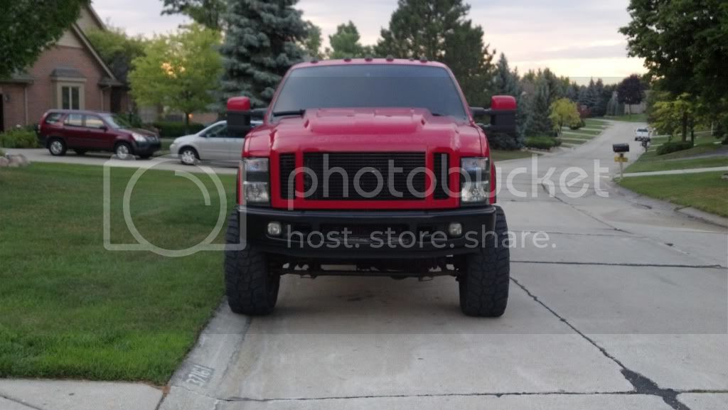

WOW! that's the best looking aftermarket hood I've seen yet for this model.:jammin:

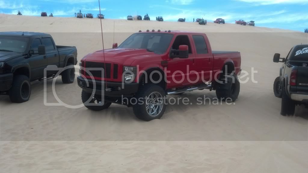

Decided to run a cowl hood. Got a Reflexxion one like this coming
