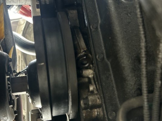

So I’m getting a p0673 which looks like it’s a glow plug number 3 and I’ve got oil dripping from this big Allen in the front is there an print or anything there?Also have trans fluid on the cooler lines right after the external filter on the trans side it’s not leaking at the fittings on the filter that I can tell is there anywhere common that they leak around there?
