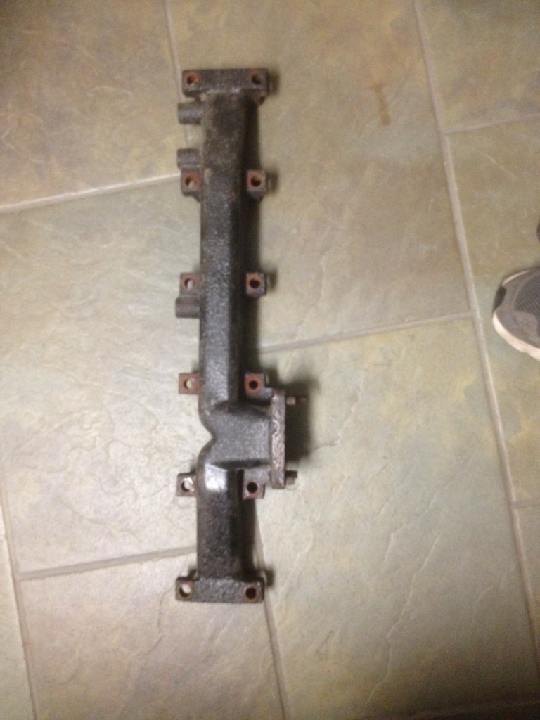

A spacer would work but it would move the turbo that much closer to the airbox, I don't want to have to worry about it getting hot and melting.
No Colton, I keep forgetting. If I did swap the exhaust housings I'd have to clock the comp housing clockwise which will make a funky IC pipe with a tight radius coming off the turbo to the IC. If we use an industrial manifold then it's basically a straight shot to the IC and the downpipe will be much easier to fab and it'll eliminate almost 90 degrees of bend on the downpipe. I think it's a better choice all around to run the industrial manifold, we wont have to worry about port matching a manifold or mismatched housings and alot less plumbing to run. My dad found a couple for less than $100 bucks, it just seems like the better route for simplicity.

I see. Just a thought. I think it will look better with a industrial manifold anyways.

That might work, my dad has a few ideas he wants to try before ordering the kit. He also found an Industrial style manifold up in Ohio for $75 bucks, they're shipping it out today. We'll be out of town starting Wednesday so it'll be next week before we pull the engine back out and massage the firewall and install the manifold.

On your exhaust manifold issue, i used a 3 piece for a 24v and flipped it so the turbo sat on top. I ran a gt3788r with no issues. I did put a 1 or 1.5 inchbody lift on the truck. On the tach, when we did my cousins bronco, his dad used the factory 302 ecm, and machined the harmonic balancer to have the correct pulse count. It works great.

The industrial style manifold showed up on Friday, two of the studs are broke off but we should still be able to get them out, it was a little over $90 bucks after shipping. I'm too worn out from an event this weekend so I won't work on it until later this week.

Another manifold that would work the same as the industrial manifold is the CR manifold. It's probably easier to find and cheaper
