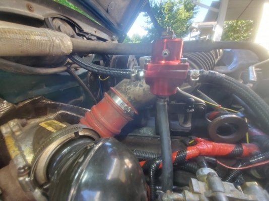

I wonder what one of those inline regulators will regulate the pressure to. Good luck !
Its the same regulator as they usenin the "regulated return " conversion kits for any 7.3 powerstroke. This particular one will regulate from 0-140psi..
Right now, i have a ball valve plumbed into the return lines to prove what i want to do could be done. I can have 0psi to whatever the pump will dead head at.
Could totally use the ball valve but it doesn't regulate properly while running because the aftermarket regulator is set with a diaphragm and spring pressure that keeps pressure constantly at the desired set pressure.
Ball valves dont move so it drops close to 15psi wot.
Should hold a more steady pressure with a 2-4psi variance wot with the aftermarket regulator.
62psi is optimum pressure for a 7.3 injector.
You can literally hear the engine change tone when cracking the ball valve open more and more up to 65psi then after that no change and thats when i found the geyser issue on the aftermarket fuel filter cap. Lol

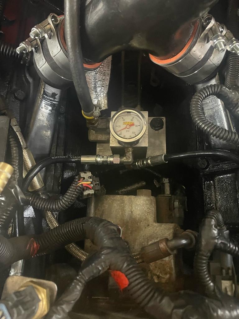

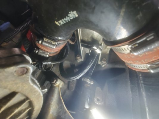

Some pics of what i came up with.

Is that a mechanical gauge running inside the cab??
I'd be a little worried about that.
Unless I was using a stainless steel braided line with the proper fittings.
The last thing you want is a fuel leak inside the cab.
I keep my gauge under the hood for that reason.
Glycerin filled with braided line.
Where did you end up sourcing the fitting to reuse the factory Y line??
After reading through the thread I’ve come to the conclusion we’re a bunch of Jerry rigging cheap asses LOL. Kidding. Keep it coming, all great work.
That black fitting? Got it off fleabay with 2 different size hose barbs and 2 new o rings for the big banjo bolt for 30 bucks.
