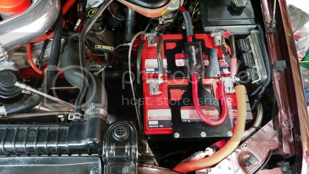

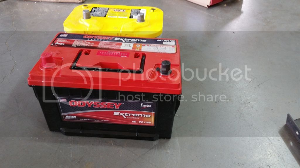

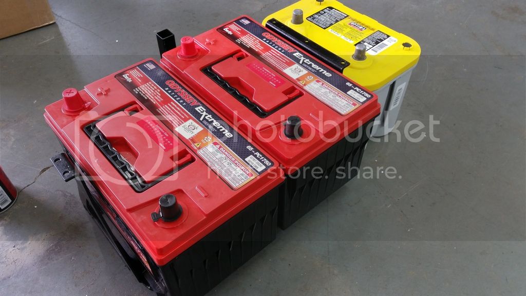

Finally ditched the Optima yellow tops for something better...enough was enough.:fustrate:

Yeah the only reason I kept trying them was because they kept replacing them for me...and someone had said the yellow tops were better than the red......
.....nope....they're both cRaP!
