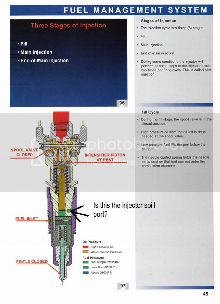

This is it right?

You cant see it unless you disassemble the injector. I mean sure, you can weld it, if you want to warp the injector body LOL
Ive seen people press in ball bearings, that usually doesnt end well!
I got six sets of welded plungers on the shelf from other builders, all been replaced.
Ball bearing is hard steel will distort the barrel.
