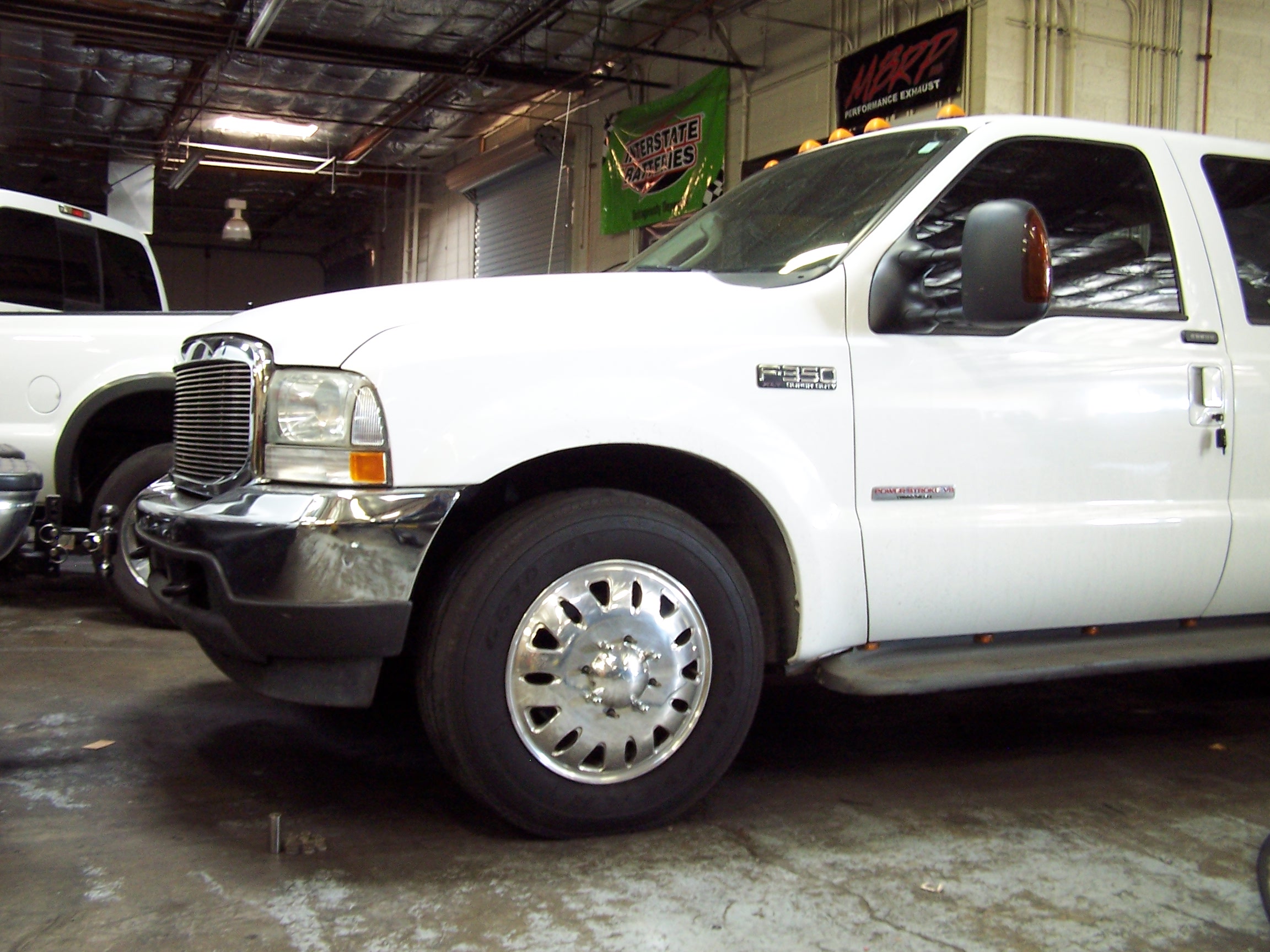

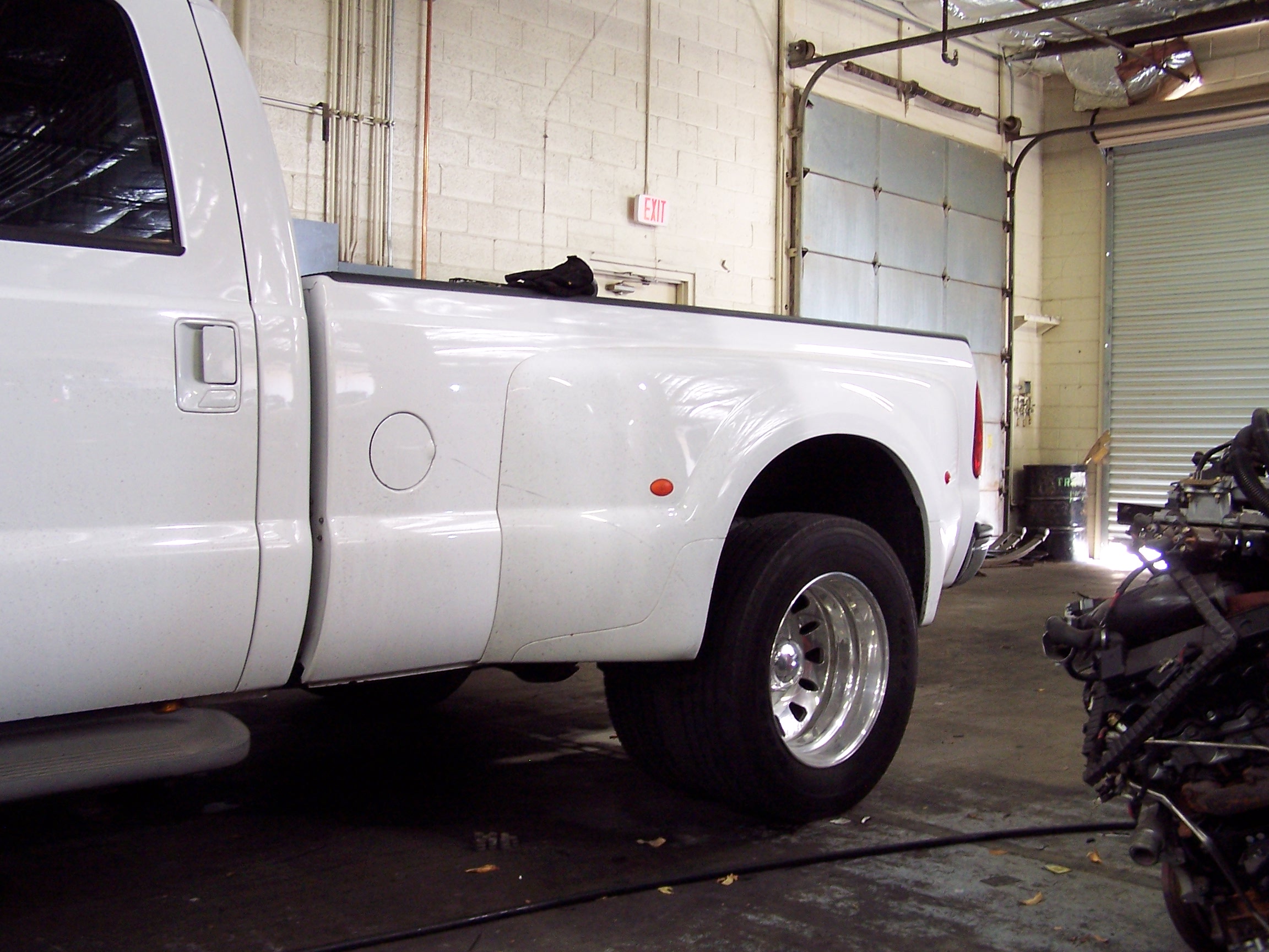

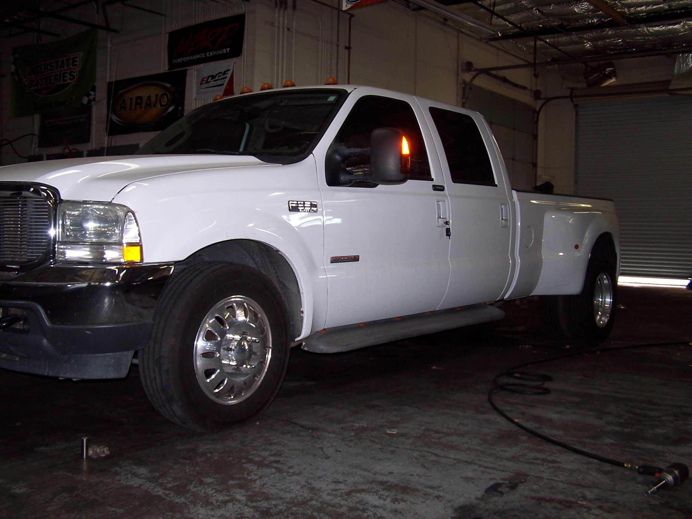

A few years ago I purchased John Woods 2002 7.3L CC/SB/DRW/4x4 truck and sold my 2004 6.0L CC/LB/DRW/2x4 truck. You can see them both in the picture below:
