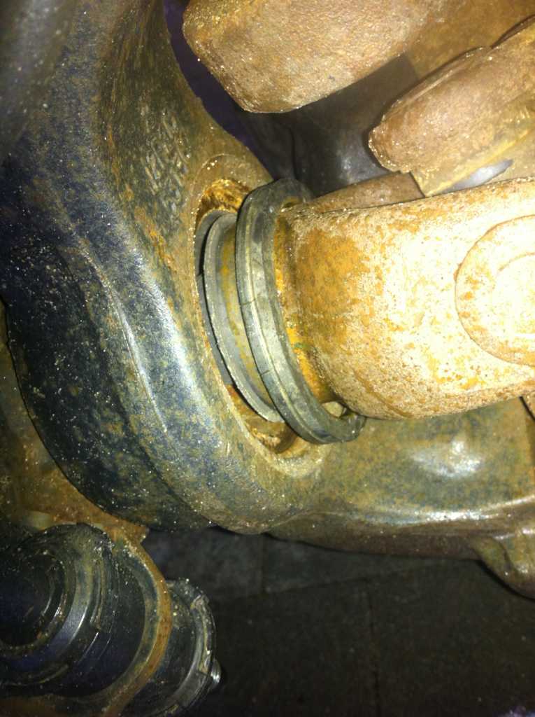

16. If no leak is found, use the vaccuum tester to pull 15 in of vaccuum on each hub. Do this from the same wheel well tee connection. If leaking here, check line. If line is good, change the three hub seals.
If you find a hub leak, I'll give you some more.
