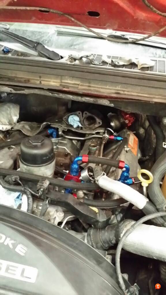

Pic of the lift pump and regulated return.

Still got a little. But of scrubbing to do in the engine bay before installing everything else.

Nope stock nozzles stock hpfp. regulated return, fuel cooler mia, and a fuel lab 200 gph pump.

Looks like I ran into a snag....apparently I got a little carried away with cutting the fuel lines....no brakes. Fack!! LOL

What! Is there a turbo sitting in there? Didn't try and drive it and found out the hard way that you had no brakes?
No turbo isn't sitting in there yet. But the pedestal is and all the oil fittings. Only thing left is to drop the turbo in and cut the oil lines and it should be ready to fire.
Luckily I didn't find out the hard way the line is sliced. We pulled the truck into the shop with a 4 wheeler and noticed a little puddle under the truck. I crawled under there and I thought it was fuel at first, until a buddy hit the brakes and well wasn't fuel. Calling ford to get a new brake line in. Hope they got in instock . :doh:

So ford only want's to sell the whole brake line and fuel line assembly as one unit....not gonna happen...I will do my own brake line.
